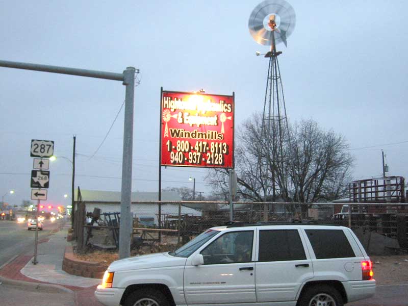

I'm interesting in putting up a windmill to pump water for irrigation (rather than running an electric pump). I have water down about 50 feet below the surface in sandy soil. But I haven't any experience in farm windmills. On Cape Cod it can get pretty windy (hurricanes every 10 years) so I'm wondering if a windmill will even survive in strong winds. I saw a store in Texas on a recent trip (picture attached), but they were closed when we drove by. Not too many stores like this up in my neck of the woods. Thanks for any advice.
