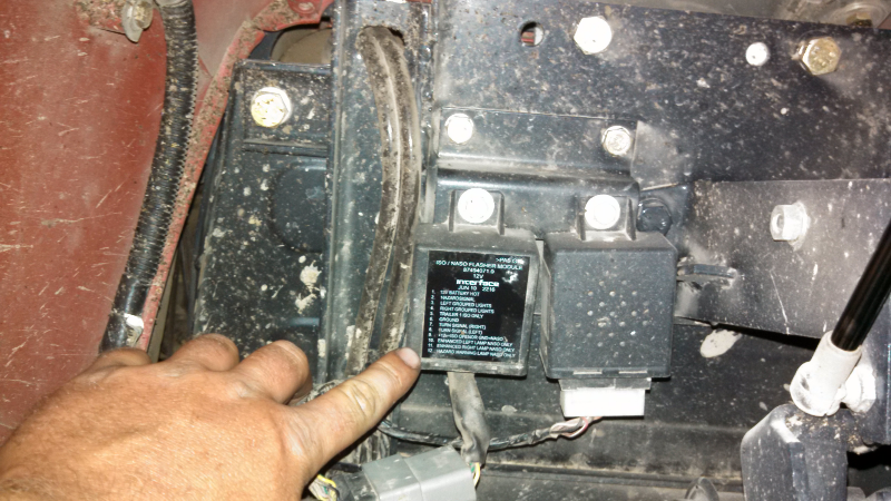

Is this what your talking about?
/ FARMALL 55A PROBLEMS #26
I believe that is what he is talking about. Can you remove it and check the wiring to ensure it is not corroded? I would follow that wire harness as well. Is there someone nearby you could swap switches with to find out if this is truly the issue?

/ FARMALL 55A PROBLEMS #28
That is the module I was talking about but after looking at it again realized it is for the lights. I thought that it was the safety module knowing the one beside it is the safety alarm as I have it unplugged to avoid listening to the annoying alarm. Kinda thought that case would have put the two modules that are in the same circuit close together, Sorry for the confusion. I could not find the safety module. Might be under the dash. Doesn't show a clear location in the parts break down but according to the schematic it has 6 pins. Again sorry if I steered you in the wrong direction

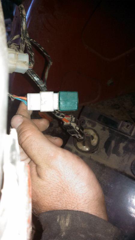

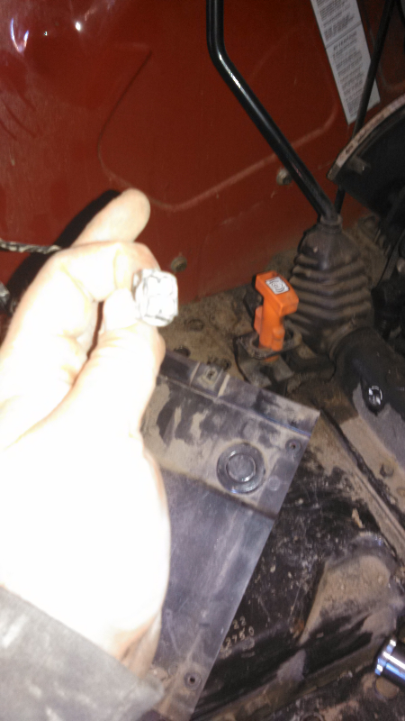

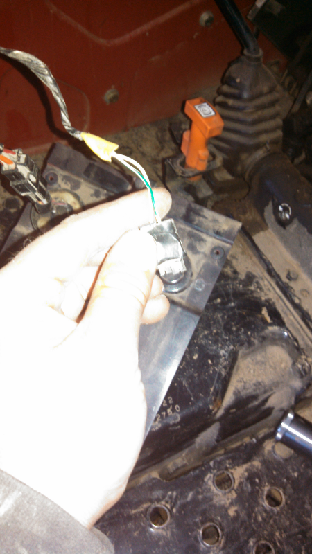

Nope that's fine! Now I know what it is! The dealer said it was under the dash I have it all taken apart and still can't find it! But what is this? It starts and runs with or without it?
And I have two wires that don't go anywhere! The green wire is hot when the key is on!?
Thanks for any info! :)

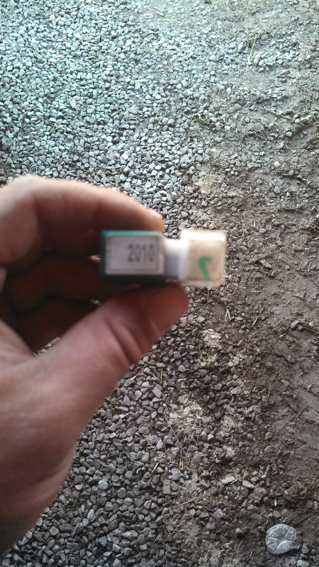

OK I have in my hand a module fuel control! In the parts manual it says and shows it by the relays! Its not there! Where is it at? I think they printed me off a page for the dx55 not sure tho! Anyways how I have come to the conclusion that this is it is that it dose not smoke out of the exhaust when it dies and I try to start it. The book at the dealer said it was one of two thing. The fuel shutoff solenoid. I replaced that at the beginning of this whole ordeal or the module fuel control so that's where I'm hoping my problem is but I can't find it! All of my wiring and switches are great shape. Just can't find where this control is! Thanks! Any info will be greatly appreciated!
#31
I found it! And it fixed it! Now I fill like doing a dance it is in a little c channel behind the alarm box! Hidden very well! Thanks for the help everyone!
