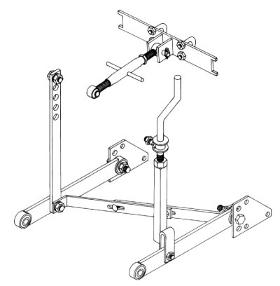

Worksaver made one for the Super A's, 100's etc., but used the existing hydraulics, and lift system. Looks like the top link attached to the rock shaft, and lift on the left arm, attached to the lift system.
Hydraulics may be the expensive part, and off center PTO will probably limit you to non-pto work/attachments.

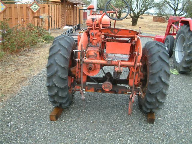

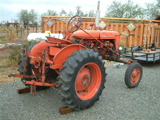

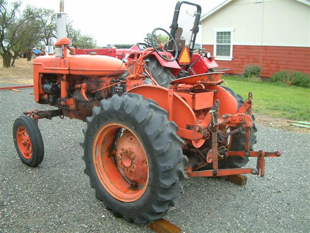

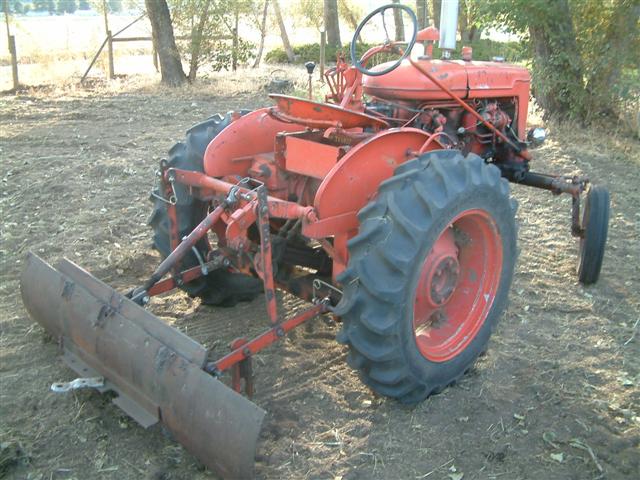

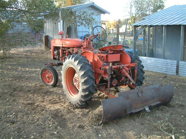

Does anyone know if an old Farmall A can be retrofitted with three point arms?
I have a 3pt on my 1951 Farmall Super A
DSCF0065 (Small).JPGDSCF0066 (Small).JPGDSCF0126 (Small).JPGDSCF0127 (Small).JPG
Tractor came with it (it's a Caltrans mowing tractor with a mid-mount sicklebar mower). The 3pt looks like an aftermarket kit.
Good luck.
