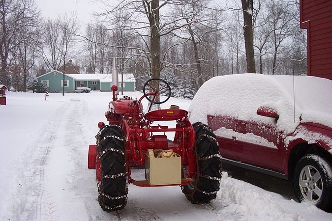

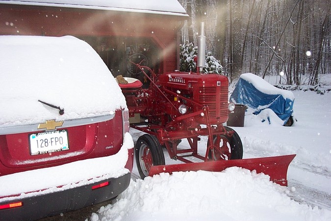

Mornin AMP762,
I run a short #00 battery cable from the positive terminal to the top of the tranny case on both my A and Super A. As far as oil I use straight #30 wt unless its very cold durring the winter and then I go down to #20 wt. The tractor starts a bit easier for plowing !
Good luck with your new A, its a great tractor !
