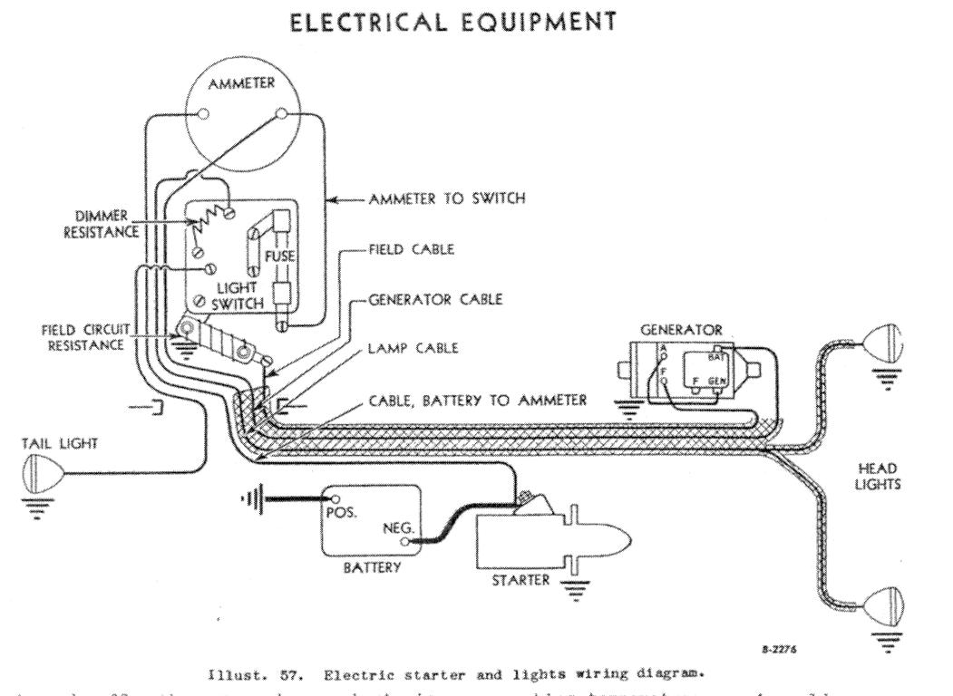

Jun 29, 2011 / Farmall super "A" #1 D Deerlope Veteran Member Joined Jun 28, 2003 Messages 1,653 Location Northern, New York Tractor Kubota L3830 03: RTV 900 I am in need of a wiring diagram for a 50's vintage Farmall super "A". Could someone please help me find one?
Jun 30, 2011 / Farmall super "A" #2 flusher Super Member Joined Jun 4, 2005 Messages 7,555 Location Sacramento Tractor Getting old. Sold the ranch. Sold the tractors. Moved back to the city. Deerlope said: I am in need of a wiring diagram for a 50's vintage Farmall super "A". Could someone please help me find one? Click to expand... This should get you going Good luck.
