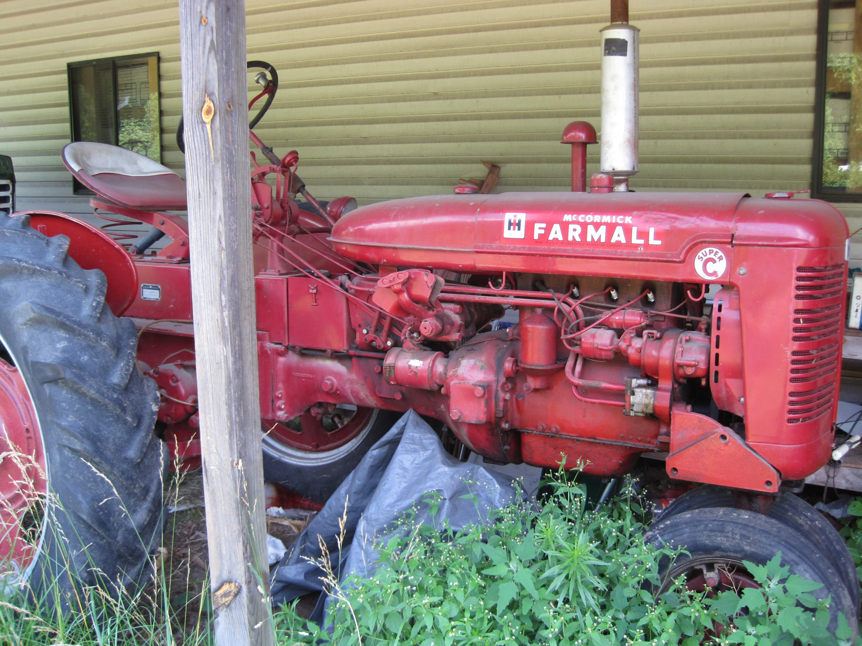

I can't seem to find the oil dipstick. Also not sure where one can add the oil to the crankcase.
Stupid of what???? I have only one view of the tactor for viewing.

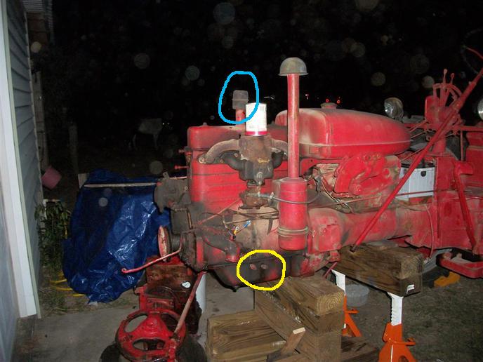

i've uploaded a pic of my C when I was rebuilding it.
in yellow, circled, on the left side of the oil pan.. there are 2 knobs going into the oil pan. they look like they are at the same level.. but they are actually a different level.
bottom one is low oil level... top one is the fill to.
easy way to do it is to add oil to engine till it dribbles from top valve, then close it. to check oil before running, cack lower vlave. should get a dribble there. if so.. it has oil. if not, add oil till it dribbles from TOP valve. always tighten both.
now. circled in blue , going into the valve cover is a lil cap a bit smaller than a soda can.
that's where you put oil IN the tractor for the crankcase.

I've never had a Super C only an M so, I'm guessing and going by memory from nearly 30 years back. I suspect that red cap sticking out of the hood infront of the muffler is the crank case breather and you add oil there. My M didn't have a drip stick. It had two petcocks in the oil pan. I was told that when the top one was open and oil ran out the crankcase was full. If you buy the tractor don't take my word for it, please get an operators manual and repair manual the repair manuals for the lettered Farmalls are relatively inexpensive.
Woops, I see Sound Guy explained it while I was typing and even threw in a picture. Way to go, Sound Guy.
Stuck
/ Farmall Super C ? #4
It doesn't have a dip-stick..Check oil level on the left side of tractor using the 2 little thumb screws. Oil fill cap is next to muffler.
