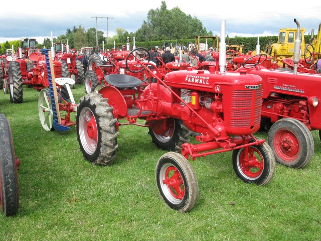

I will take a guess and say a 1951 Farmall Super A or 1949 Farmall C if the id plate is under the seat on the seat mounting.Most farmalls have serial tag on the clutch housing but Farmall A ,B,C were on the seat mount.The 1540 is the maximum rated RPM of the engine .The chassis prefix will be FAA and the engine prefix will be FAAM ,which should be at the front of the engine block above the distributor for the Super A.The engine will be offset to the left with a wide front axle.Pictured is my 1941 Farmall A (with mower)which was replaced by the Super A,and i have included some pics of the serial plate and location of engine number. Does the tractor you are looking at look anything like this? The Farmall C will have the steering shaft go down the left side of the tractor and the engine will be centered.The Farmall C can be wide front or narrow front .Chassis prefix will be FC and engine prefix will be FCM.I have included a pic of a Farmall Super C also.
I hope this is of some help.

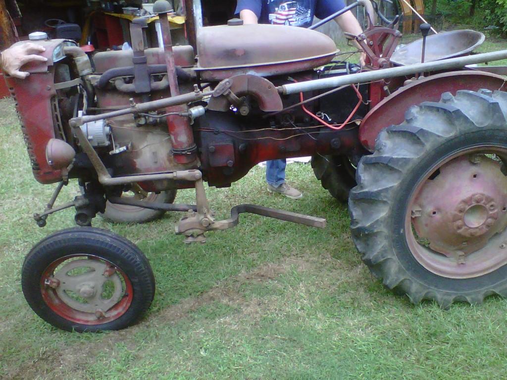

I have learned it is a Super A but not what year it is. The plate under the seat is unreadable. Numbers I found on the engine and transmission include 351687-R4, 92511, 10181 and 354898R. Farmall.jpg I attempted to attach a picture, hope it works.

pretty straight looking machine you got there!
   / Farmall #11
Super A's were built between 1948 and 1954ish...tires and rims (on this side) look great...most likely converted to 12 volt which is good...check the gas tank for rust (when I see an inline filter, I automatically think rust in the tank)...what's in the back end of the tractor..ie. does it have a Fast Hitch? BobG in VA

Looks to be a good straight Super A.Should be easy to restore if you are wanting to do that.
On the transmission housing there will be raised numbers and a letter in Day,month ,year format.,2.6.W for example
These can be used to work out the date of casting.These codes can also be found on the engine block
Original IH casting Date codes for 1948 - 1954: 1948 - R . 1949 - S . 1950 - T . 1951 - W . 1952 - X . 1953 - Y and 1954 - Z
