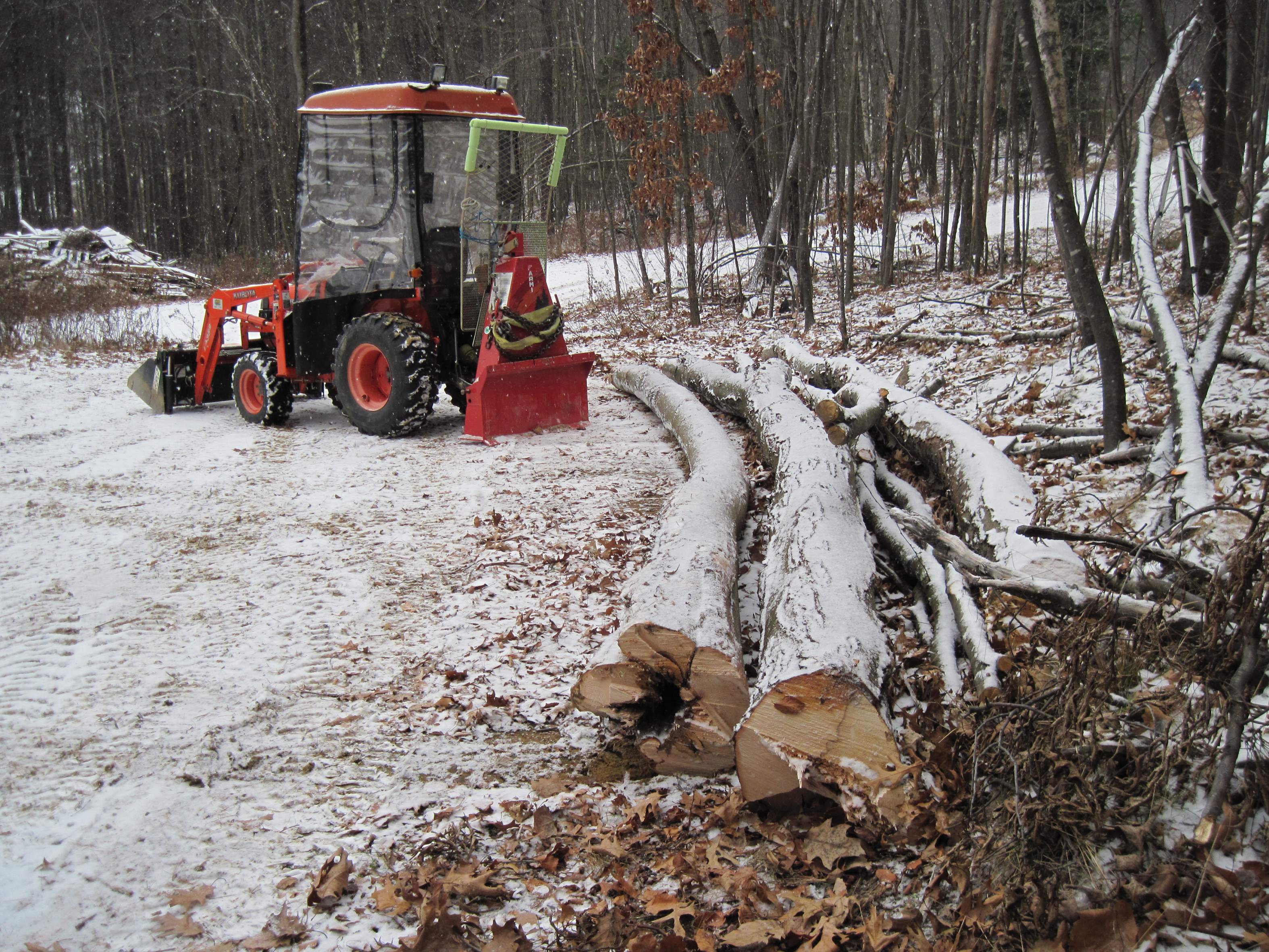

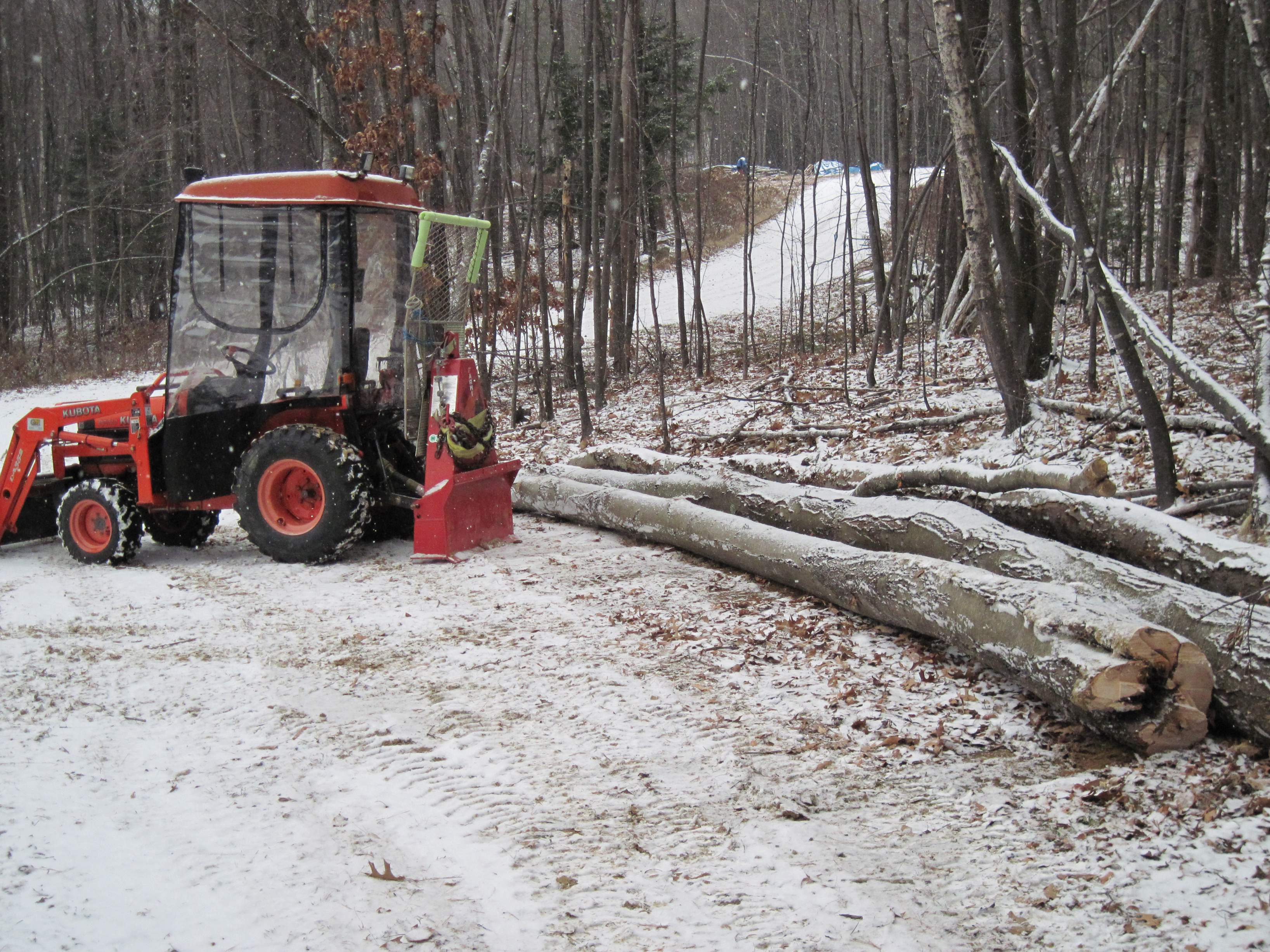

Here are some pics of a couple of trees I pulled out last December.

Your tractor is just about the same as my B7610. I have the JL290 and it works GREAT on it.
It will pull just about anything you are willing to pull behind the tractor. Very powerful units.
You are not far from me ( Concord ) if you want to stop by and see it/try it.
I highly suggest getting a self release snacth block anlong with the chocker chains. Makes life so much easier!
View attachment 315711View attachment 315712

If you want to put a winch on your 2516 that would be the one to get. I don't think you could find a better match for your tractor. If it is used don't wait to long on buying it or it might be gone. They are hard to find.
I have used my JL290 constantly in the past 11 years for both firewood and softwood saw logs on a 30 hp tractor. It has not given me a spec of trouble. Here are a couple more pics of a JL290 at work.
