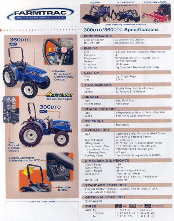

This is the REVERSE side of brochure attached with specs.
I wonder if I could raffle off tickets for the Shibaura SD2200 4X4 with FEL once it is repaired and get enough money to purchase this FARMTRAC tractor. It's a thought anyway... wouldn't take selling about 15,000 plus at $1.00 each to pay for tickets and tractor. Or about 3,000 plus at $5.00 each. Like I said... it's a thought.
What do you all think about this tractor. The Dealer is close by and the business has been in business for atleast 30 years. What are the Pros and Cons of this tractor? Is it made in China? What can you tell me about it's record? Is it a new manufacture making these or do they have a track record as well?
Thanks for your time and input.
Jim

The farmtrac is made by LG in S. Korea. Do a search on them as well as Montana tractors, also made by LG. So far the members that have them seem to like them.

It is made By LG as was mentioned earlier,Korean Mfg not Chinese.They use a 4 cyl Mitsibishi Diesel engine.Parts are readily available and they are as reliable as the majors
