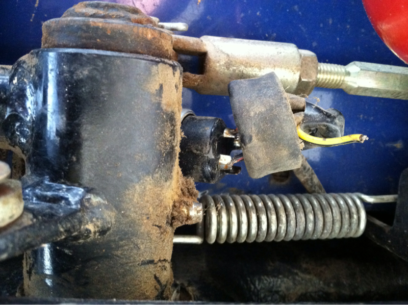

Hi, I've got a Farmtrac 360 DTC that has always ran well and operated like a dream. Yesterday I was sitting on the tractor while it was running and turned it off to hear something my son was saying to me...when I tried to restart it, nothing happened, at all..
The only way I can describe what it's doing is to say that it is acting exactly like it does if the PTO is engaged or the clutch is not engaged when trying to start. In other words when the safety bypass is not allowing you to start the tractor. I've been doing some land clearing, which is rough on tractors, but I almost have a feeling it's just a part gone bad...
Can anyone tell me what it might sound like to them?? Switch relay? Disconnected wire...hung selinoid?
Any suggestions would be appreciated!!!

I would check wires under tractor such as brake, PTO and similar safety switches as wires can ripped off by branches.

I had the clutch safety switch vibrate loose and fall out of the little bracket that holds it after a few hours of tilling with a borrowed Kubota. Thought I killed the tractor. Scared the crap out of me!

We had a FT 360 ... I know this may sound simple since you probably were not using the PTO ... but, have you checked to make sure the PTO switch is not turned on. Where it is located it is possible to turn it on with your knee without realizing it (I know because I had ours not start a few times :eek:).
Otherwise I would check the wiring from the clutch safety switch to make sure it wasn't pulled from brush. I doubt the PTO wire would be pulled lose since it is not located under the tractor. But, any of the switches could have gone bad.
As far as I know there are only the clutch and the PTO safety devices that prevent starting. I know the 360 does not have a seat safety switch and I don't think it has a switch on the brakes.

Ok, the first thing I checked was the PTO switch, and it was not on..I actually turn it on when I turn the tractor off on a regular basis as a safety measure in case one of my children were to hop in the seat and try to start it...so I'm used to turning it off in order to start it.
I talked to an 88 yr old tractor mechanic today and he said "no matter how much you think it can't be the battery, it probably is!" So as soon as I pull it out of the woods, I'm going to check all the connections and replace the battery.
I will also be able to check the clutch safety switch a little better once I get it up on some concrete by the tool shed.

Under to foot pan on the left side on the clutch pedal there should be a clutch switch. Check to make sure you did no snag the wires and disconnect it or pull the wires out.

Aha! Found it...apparently the yellow wire on the clutch safety switch had broken! Took me literally about 2 minutes to find it once I had a friend haul me out of the woods today...I used a jump wire to test it and she fired right up......gonna be hard to get to for resoldering....
