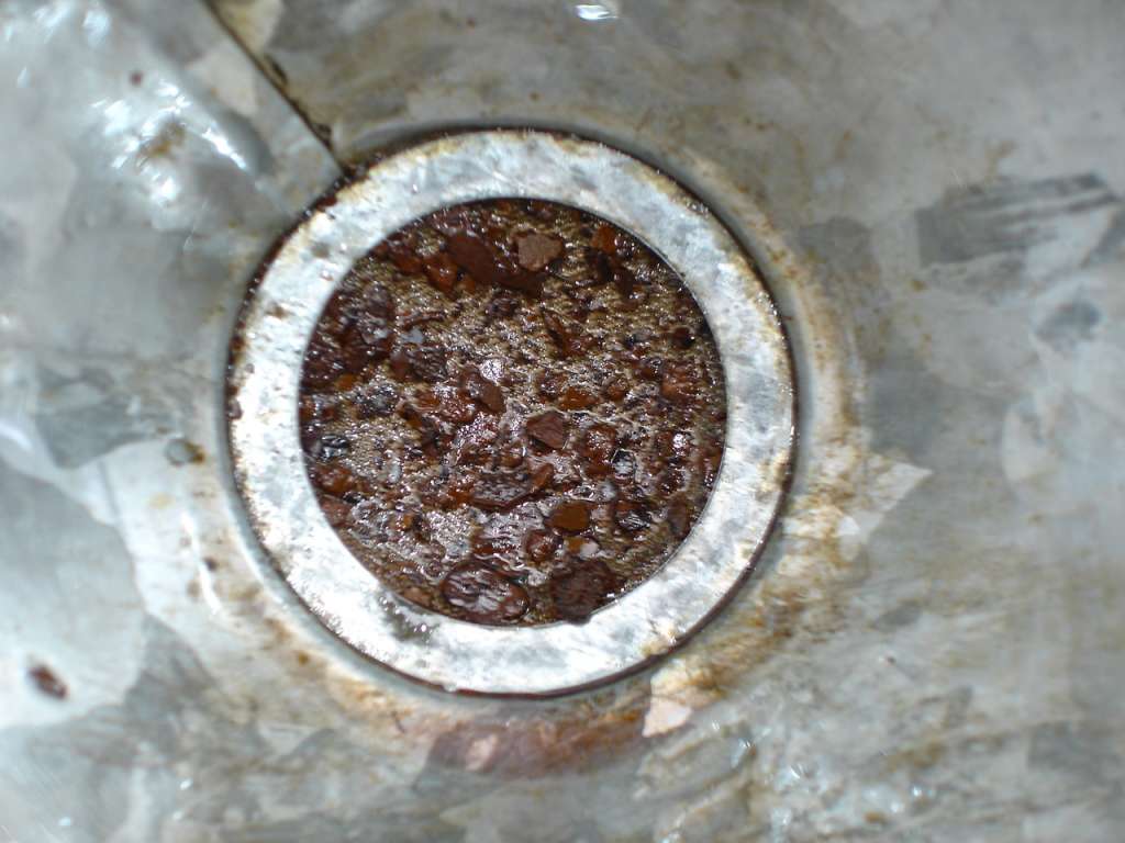

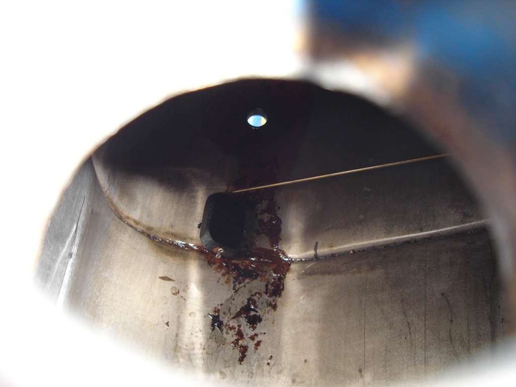

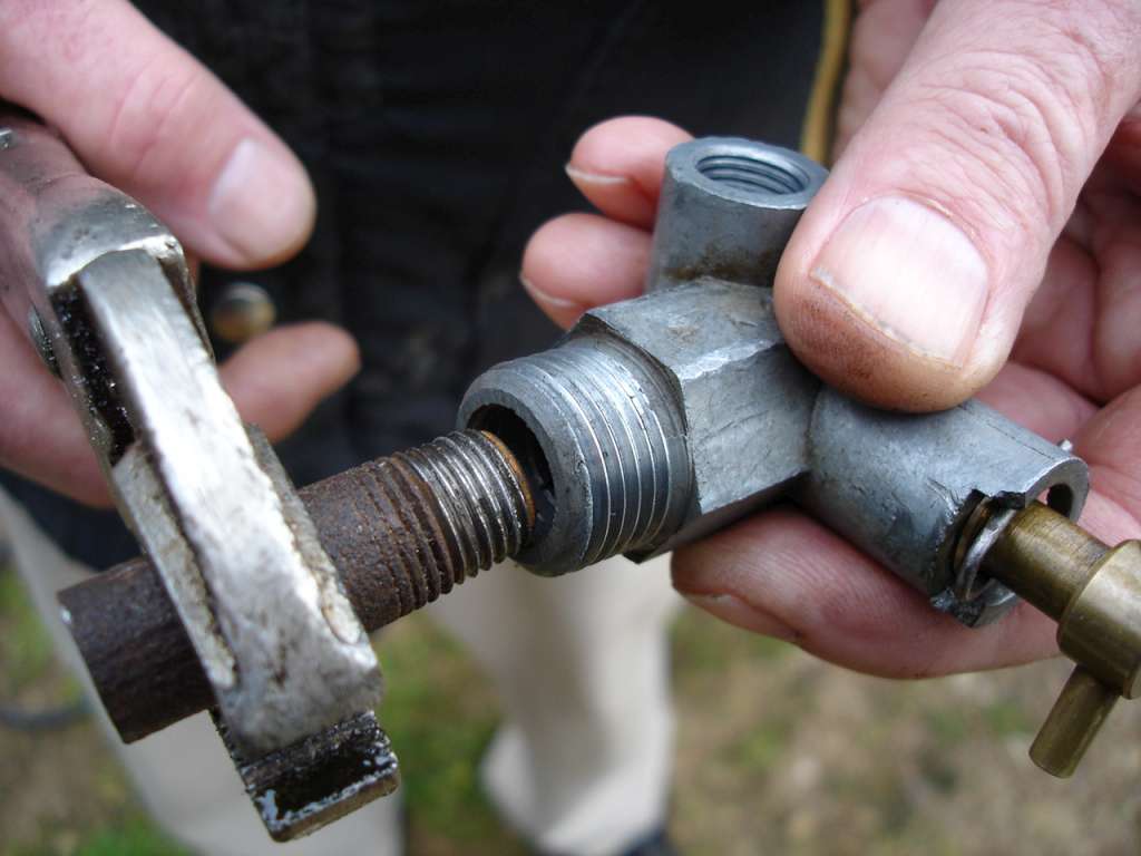

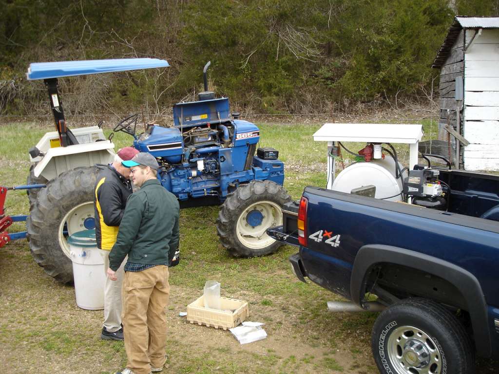

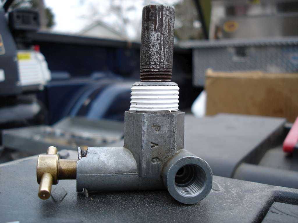

I have a few pics.
Trash in tank before flush.
Screening the flushed fuel. We flushed it about 4 times with a gallon of fuel each flush. I used a wire to loosen up the sediment. By the end we had little to no trash in the tank.
The valve body was soft enough to screw a steel pipe in it. Worked perfectly for a pickup tube.
