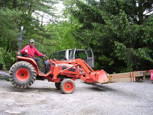

Last summer I did not have an implement on the back, but wanted to get six 16' 6x6s out of the back of my van. I thought the loaded tires would be enough. They almost were.
I have attached a photo of my rear wheel about 8" off the ground. Note how low the bucket is. The loader lifted the weight without problem. And the load was centered so there was no side pull that might be caused by an unbalanced load sticking out on one side.
This situation was totally controlled, because as soon as the end of the 6x6 touched the ground, movement stopped. I could raise of lower the rear wheel by moving the bucket up and down. If the load had been entirely in the bucket, and did not extend outwards quite a bit, this would have be a pucker factor situation! The reason being that I did not have enough ballast on the back or counter the weight the loader could lift without problem. So here is the proof that you need ballast when using the loader within it lift capability. And loaded tires may not be enough ballast. They are not enough for my tractor.
edit: I forgot to mention that most of the time the rear wheels were on the ground and the load could be moved. All it took though was a slight change in the angle of the driveway surface to make the tractor start to tip...

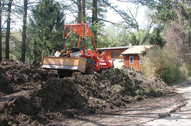

This shot was a couple days ago.
Ballast is the more normal 60" box blade with four 12" concrete blocks on top...
