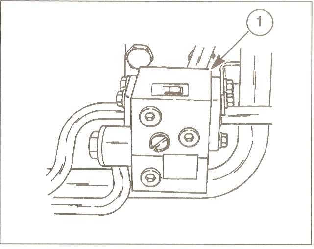

Untitled - 1.jpgWell, no luck there, so maybe someone can tell me which port is what on my diverter manifold or really just which one should be the power beyond.
   / FEL boom is slow and leaks down after new control valve #3
Any pictures of how you plumbed it? How does it feed the rest of the tractor? Did you use a power beyond adapter? Did the old loader valve have power beyond?

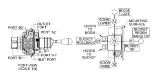

Cap2ture.JPGBasically the same valve with power beyond. When I swap ports the boom works good and the bucket gets crazy. A1 and B1 for bucket, A2 and B2 for boom. PB outlet on side and tank on top next to A2. P,PB and tank plumbed into manifold which I never touched. The valve is open Center and has the PB sleeve. When I use A1 and B1 for boom it works the boom fine. When I use A2 and B2 it just barely lifts and then bleeds off.
   / FEL boom is slow and leaks down after new control valve #5
Just to verify, you also have a tank line?
There should be 7 hoses going to the valve. The 4 "work" ports....A1, B1, A2, B2.......that go to the lift and curl.
Then there should be a P (pressure IN) port that comes from the pump.....a PB port that goes on to the rest of the system, and a T (tank) port that tees back into the sump or another return line.
So you have 7 correct?
If this is the case, it sounds like there may be something wrong with the A1-B1 float spool in the valve.
That's what I was thinking, all 7 lines are plumbed right, checked and rechecked.
   / FEL boom is slow and leaks down after new control valve #7
A2 and B2 (which is ONE spool / function) works on both the lift and curl
And A1 and B1 (which is the OTHER spool) dont work on either....I think that is your issue
