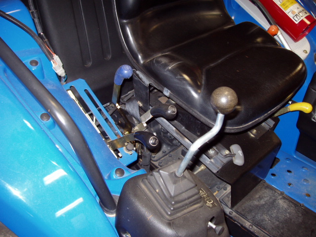

The first photo shows the blue lever that will control the grapple, push forward for close, pull back for open. Pretty straight forward.

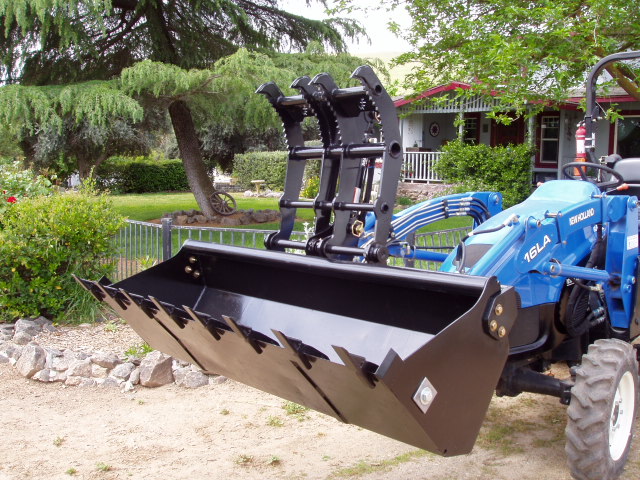

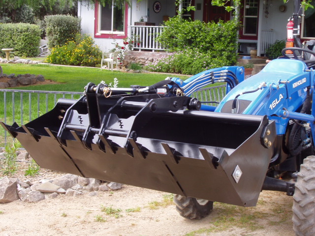

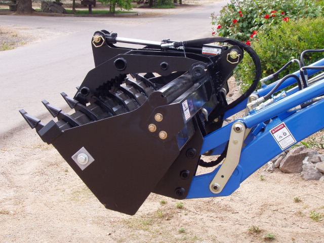

The next two photos show the bucket in the full curl back position and yes, I did re-paint the nine year old bucket. You can see the backward "S" of the hydraulic hoses and the great "overbite" of the grapple jaws. It took a cylinder with a 10" stroke to get that done. As far as the meshing spacing between the toothbar teeth and the grapple jaws, there's 1-1/8" of air between them-something to carefully research before the installation.
And finally, the monster opens up! 40-1/2" from the grapple jaw tip to the bucket cutting edge.
