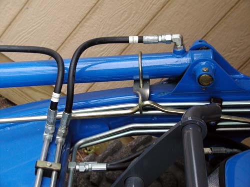

My New Holand TC 35 (16LA loader) has a rod with a notch in it (a small bend in the rod). The rod slides parallel to the loader arm as the bucket tilts...the notch sits on the support bracket when the bucket is level. When the bucket is tilted forward the notch slides forward, when it is tilted up the notched part of the rod is back. It helps align things when approaching a stump or log that I want to lift with the toothbar.
This sounds identical to the rod in the tube...with the addition of a surefire way to know where level is. Perhaps a stripe painted on the rod would accomplish the same thing.
Chas
   / FEL bucket orientation indicator #8
Here is a picture from the NH 16LA loader. As described eariler, when the notch is centered on the bracked, the bucket is level. Having used Green and Orange tractors, I find this one the easiest to use. Just my two cents...
Mark

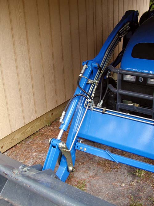

Thanks, for this pic. Do you happen to have one that is shot from a few feet back. Kinda get an overview of the whole hook-up. Thanks.
JohnS
   / FEL bucket orientation indicator #10
Here is a view from a little farther back. I little harder to see. This is actually a pretty simple setup. You would just have to figure out how to attach the rod at the bottom on yours. The bracket is held on by a u-bolt, it's just a piece of metal with a hole for the rod to slide through. Good luck...
