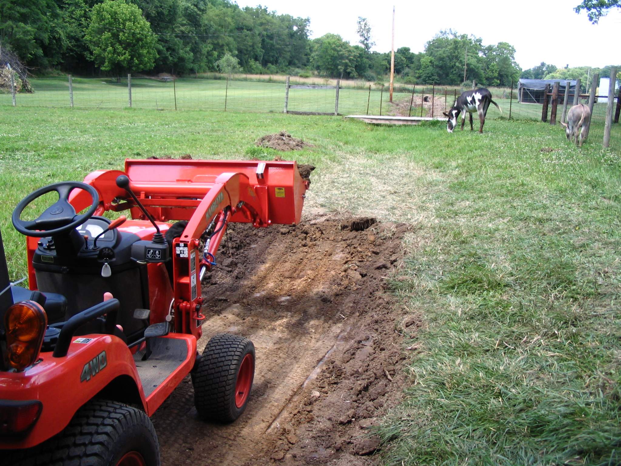

A FEL on a compact tractor would be perfect, especially with your soil. Just remember to get a toothbar on it. Here's what I did with mine on an overgrown drainage ditch.

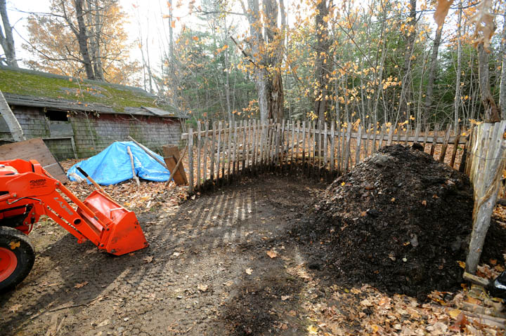

Three years ago I was searching for a tractor for 10 acres and thought of getting one without the loader. The fine folks on this site talked me into getting one and I think it was the best advice I got since my parents told me not eat sand.
I had no idea how much I would use the loader for just odd jobs. The following list is far from complete: haul wood pellets to garage, haul rocks of various sizes, make improvements to woods roads, push brush into piles, improved drainage in my driveway, loosen rocky soil before tilling for 25'x90' garden. I even used it to remove the soil 5-6" deep when I was making a 5'x5' sandbox for my son.
My most regular job for it is to turn my compost pile. I used to turn compost by hand and it took me almost 2 hrs to turn about 1-1.5 yards. Now that compost pile is about 2-6 yards depending on the time of the year. It takes 10-30 minutes to take care of and I don't break a sweat.
Even the smallest sub-CUT tractors will have a useful loader that will pick up 450-500 lbs and will do it all day long. The tooth bar is an aftermarket add-on that you can install very easily. It helps a great deal when digging into unbroken ground.
Good luck.
   / FEL capability/limitations #8
Here are a couple of shots.
