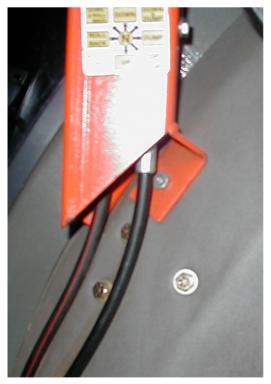

This must happen more than you’d think with cabs… My L4200. See attached pic. As you can see I have short bolts in the extra holes, not a real problem… may even think of something to hang on there. On my fender it was only 3 holes easy to fix, no welds were broken. KennyV.
