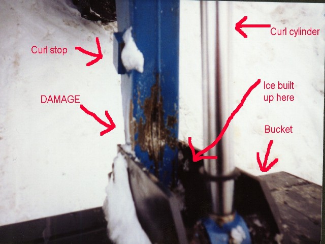

First major damage to the new tractor, well it not new anymore 180hrs. Scratches and dents don't bother me to much. I try to avoid them but the happen. This damage is to the structure, and I don't like that kind.
What happened, I Think, is that I was using the FEL to remove one day, 10 hrs worth. The next time I used the FEL the snow in there turned to ice. Black bucket getts heated up by sun, below freezing temps at night. When I curled the bucket it tried to compress the ice and damaged the FEL arm. In the summer I never had a build up problem with dirt or even mud. Most of the time the snow doesn't stay in there either but it did that day.
It split the weld. Concaved the top of the arm. Sides are bowed out a little. I have already welded a plate on it.
I didn't feel anything when it broke. I noticed it when greasing the FEL.
Hopefully this doesn't happen to others playing or working in snow. I keep an eye on it and clean it out when needed.

OUCH! That's a bummer. Thanks for sharing though, maybe the rest of us can avoid a similar plight.
I've had the snowblower on my garden tractor frozen to my barn floor from melting/freezing. Once had to use a sledgehammer to free up. Now I leave it raised while stored.
Water sure is powerful stuff, isn't it /w3tcompact/icons/smile.gif

Derek,
I know just what your sayin' about that snow and ice buildup where the bucket pivots. I get that too. Been tryin to keep it clean. Not much chance to melt in this cold weather being outdoors all the time. I'll watch it even closer know. It's too bad we had to learn about it this way.
DFB

Don't feel to alone, I had a rock wedged behind my bucket on my Ford backhoe, between the end of the dipperstick and my bucket. In use things sometimes get stuck in places, usually in the teeth and then you have to "floss" by running the bucket on the ground or on a stump.
This time a rock had fallen from the sides of the trench probably. (have to get out my TLB book and re-read that page about doing a professional job i.e. keeping the top of the sides of the trench clean). Being I guess terminally dumb and lazy I tried different positions to bounce the rock out, even lifted the dipper all the way up, would have been great if the rock rolled out, bounced off the dipper/boom junction like a ball in a pin-ball machine and hit me in the fore head. Maybe then I would have learned without damaging the hoe. I curled the bucket back (open). Rock didn't come out but I assumed hydraulics would stall when bucket hit rock.
WRONG /w3tcompact/icons/frown.gif hydraulics stalled after bucket it rock and then due the great leverage pushed it backwards crushing and splitting open the dipper stick. My friend the huge equipment repair guy repaired it so it is better than it was originally, also at the time put some rock/dirt guards to protect the grease fittings (kind of a poor man's way of trying to copy what Kubota has done on their newer hoes). Now and then he would throw something out to amuse himself...
