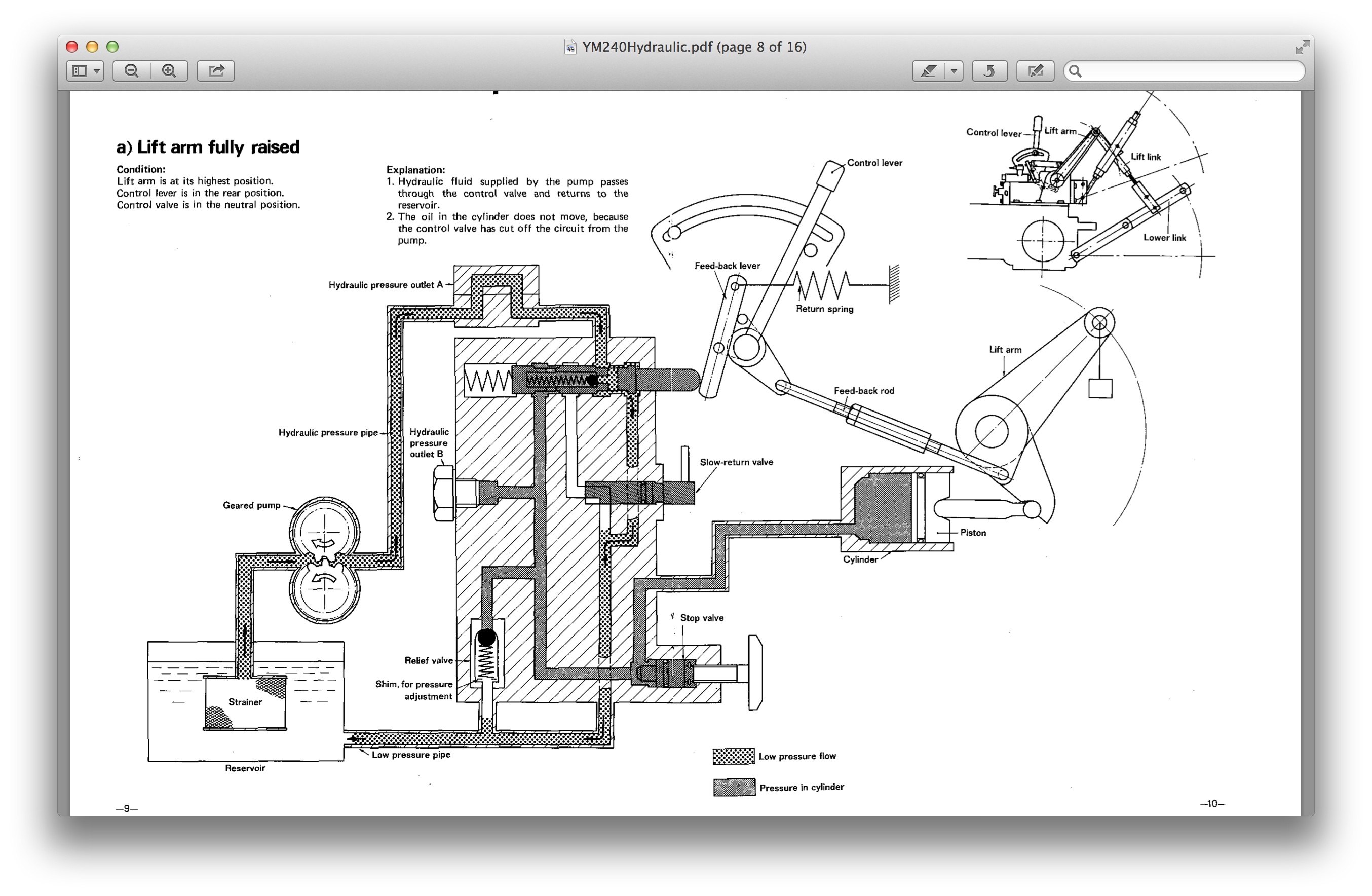

I would think it only makes sense to have constant pressure when 3pt is lifted. Cause its only a one way deal not like a cylinder. Gravity pulls down implement and forces the piston down to push fluid out of the cylinder. To combat this the fluid would have to be pressured all the time. As you lower the lever it allows the pressure to go down as the fluid is leaving the cylinder slowly as gravity is allowing the implant to go down.
What you describe would certainly work. I'm trying to figure out what the attached diagram says.
My simple understanding is, when actual lifting is required the system is pressurized. Once it's reaches the expected height, the system is smart enough to see that and it locks the fluid in place- no added, no lost- and the 3PT stays in place without additional pressure. When it comes to lowering the 3PT, it's done by gravity.
Also note in your attached schematic that the relief valve is between the pump and stop valve.
