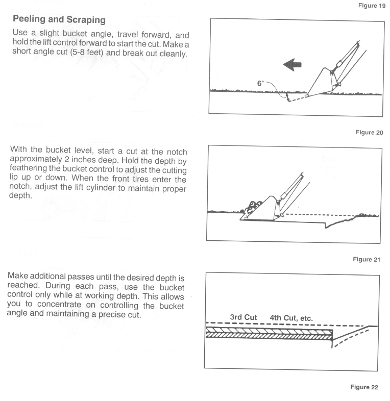

I could sure use some suggestions on the best way to dig with the FEL. Not looking to make huge holes, max 2 feet deep.
Whenever I lower the loader into the ground, even in soft dirt, the front end of the tractor lifts right up. This happens with my newly installed digging forks, as well.
I can get down into dirt by moving tractor forward (slowly), but I am concerned about the amount of strain I am putting on the hydraulics.
Tractor is 65HP Belarus 4WD, with Hardy ST85 loader - 84" bucket.

You need to get the "feel" for how sharp an angle, and how much down pressure to apply while digging. If you are applying to much down pressure, you will lift the front end. Start going foward slowly, with the bucket angle just a little foward of level, and gently lower the bucket to engage the ground. You also need to slowly curl the bucket up as you dig. It will take a while to get the hang of it, just got to keep practicing. Also as stated in the previous post, if you don't have a tooth bar, get one. The difference is like night and day.
   / FEL Digging Technique #5
Here are the instructions on 'Peeling and Scraping' from my New Holland owners manual. I am not sure if it is relevant to what you want to do or not.

Spencer - Thanks, this gives me a good idea of the correct technique. Now, just have to find the seat time to practice, practice, practice. Thanks again. Ron in Central New York

RON; u have to curl your buckek to actually dig and sometimes u have to move forward slowly. the hardest part is breaking the top layer of sod and dirt. just pratcice , u will get the hang of it.depending on the type of soil and the condidtion of it , u may want to take little bites .

Also make sure your FEL is not in the float position. I used to dig that way and its much harder. Use float to get the FEL on the ground and then center the joystick boom control.
