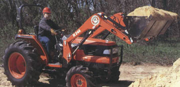

It's not that the dealer won't get me the Kubota FEL, only that he has recommended the BH M246 FEL. BTW, BobinCols, you hit the quoted price for the Kubota FEL right on the head. The literature I have lists the LA482 loader for the L3010 but says that the LA481 is still available. I haven't seen either loader as they didn't even have a L3010 in stock at the time that I talked with them. I guess I'm due another trip to the dealer. I'll attach a scan of the M246 from the BH literature.

In the picture looks like he could use a little rear ballast.
