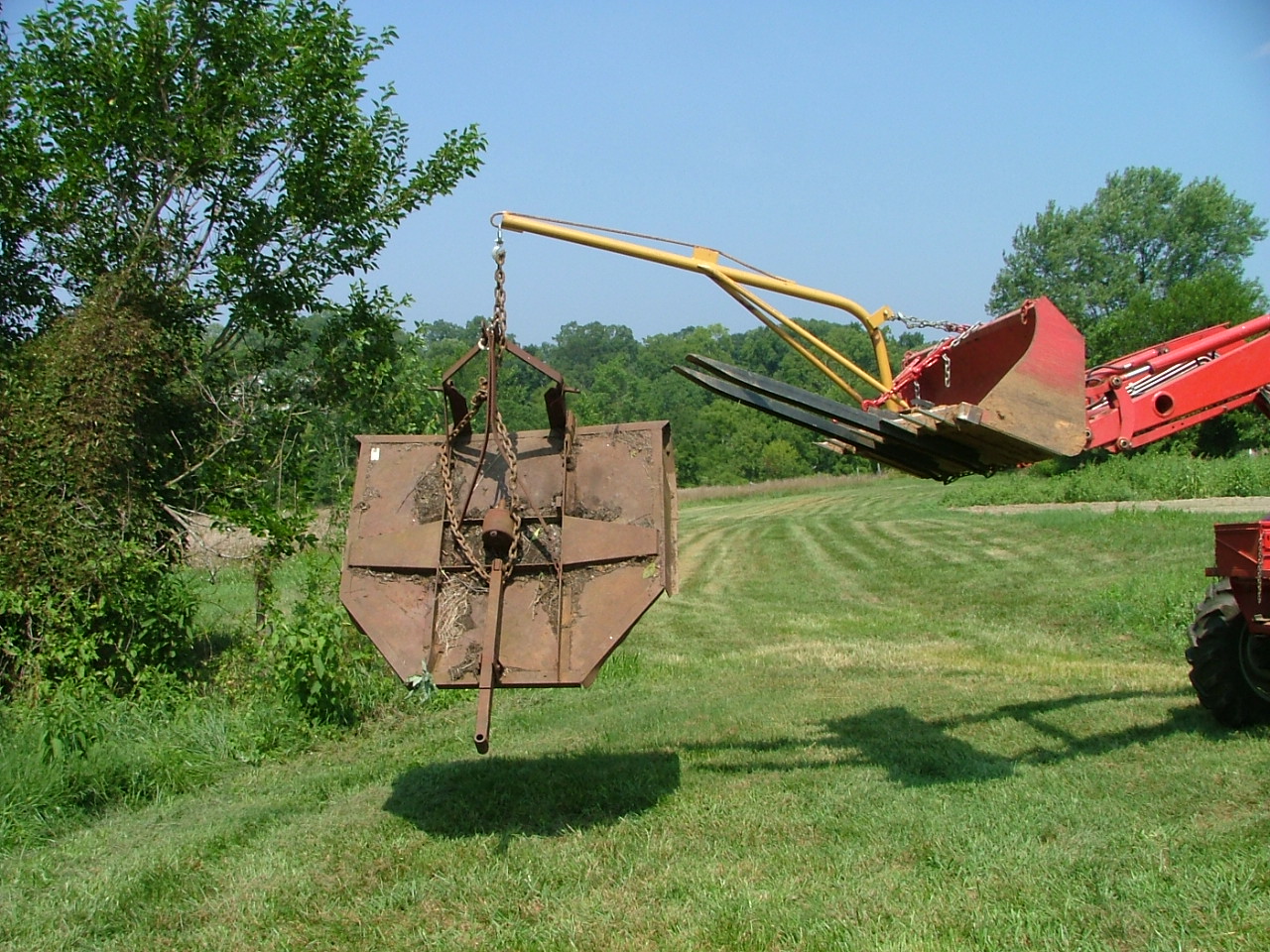

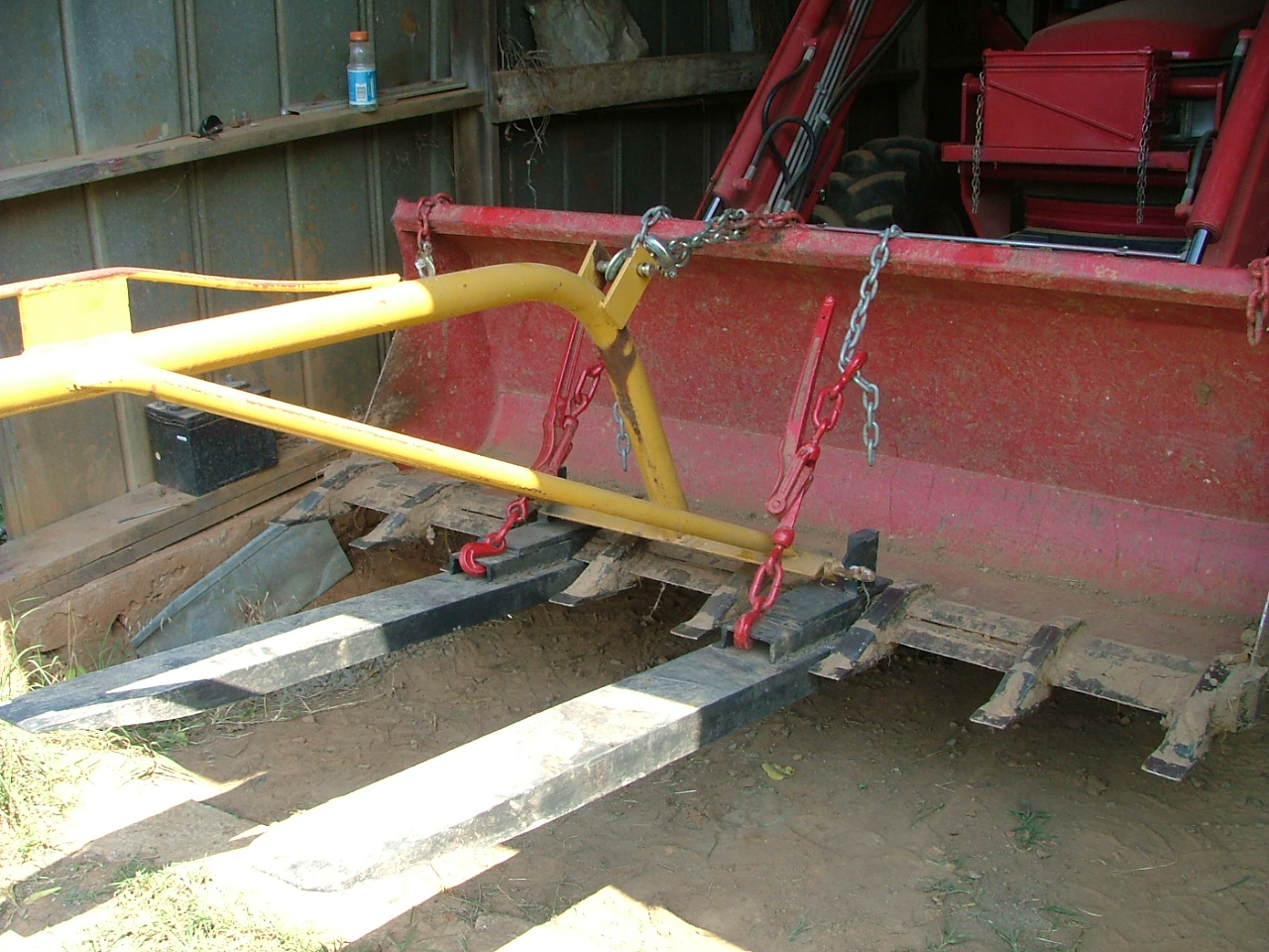

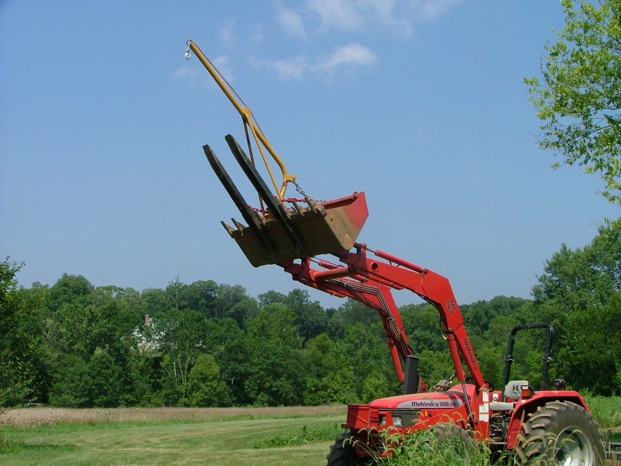

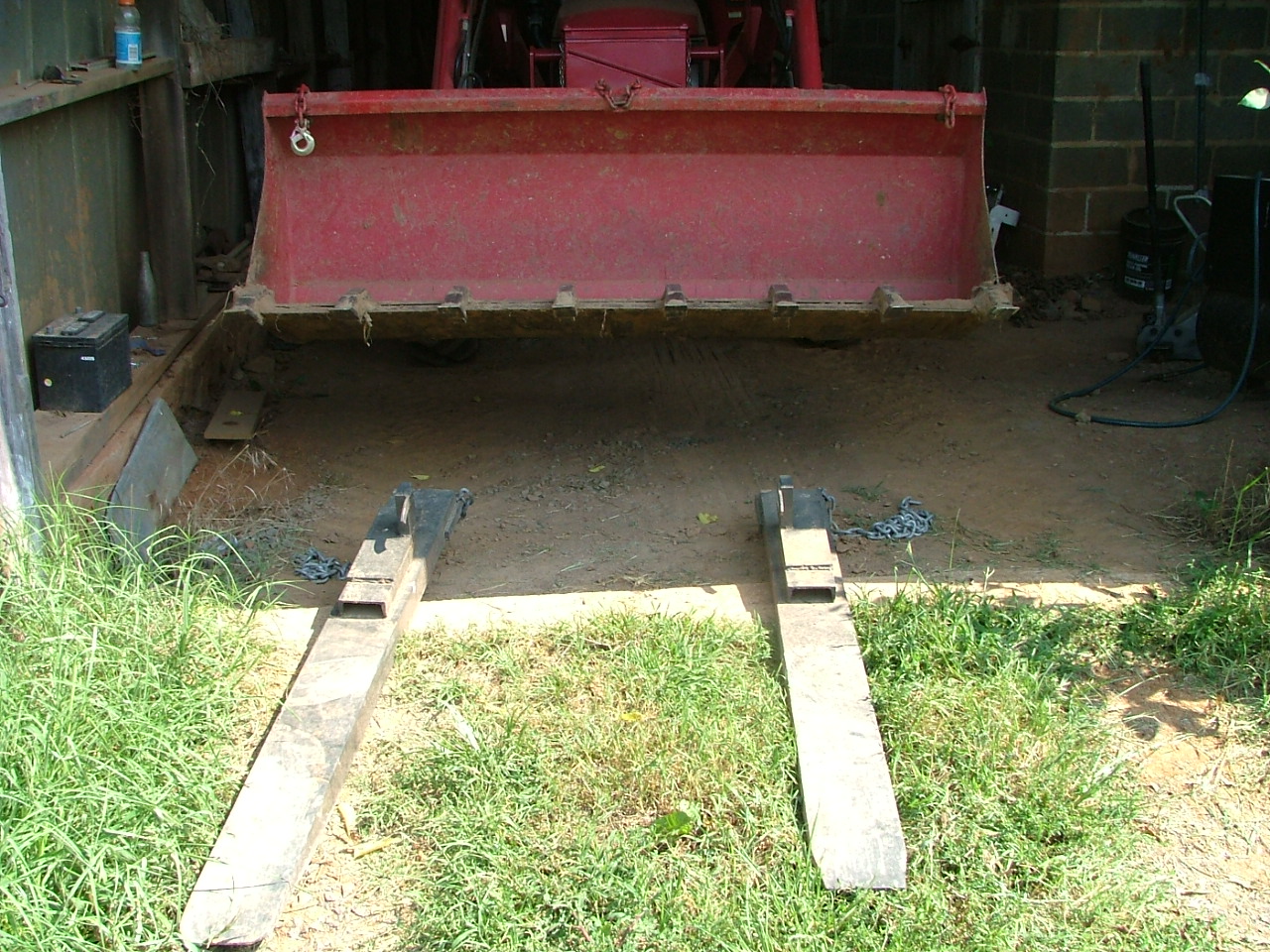

I've had these done for about six months now and finally took some pics today of my FEL bucket forks (with toothbar in place) as well as a 3pt boom pole that I rigged to fit the forks/FEL bucket. The forks are made from 6" wide 60" long pallet forks that I welded up with 4" C channel and 4" flat steel. Painted them Mahindra Grey to match the grey parts of the Mahindra 6000 that it's hooked to...I think the old NH brush hog weighs about 500 lbs....BobG in VA

Here is my boom pole, bolted to my forks.
