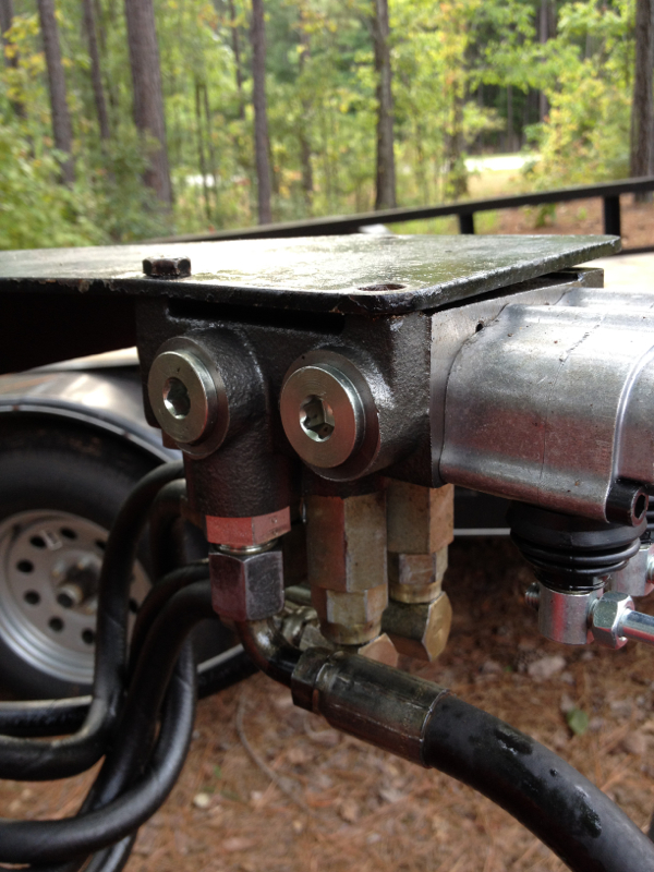

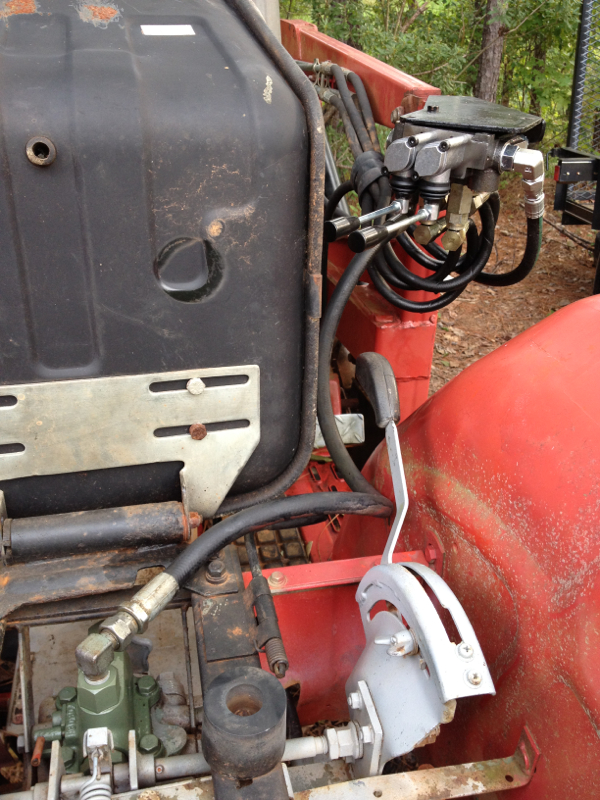

Can you show some pic of the valve side ports?
Did you connect both the PB port and OUT port?
If you have a PB port, it should be used with the correct adapter, and this outlet feeds the 3pt.
Irregardless, if the FEL IN port and the work ports are connected correctly, the FEL should work.
If you use the PB port with out the adapter, and the OUT port is connected to tank, the would be PB fluid will flow to the OUT port, which has the least resistance.
Do you have the PB port connected to the 3pt.
The PB adapter is either a hex screw or a hyd sleeve. This will separate the flow so cyl fluid will flow to the OUT port and PB fluid will flow downstream.
What is the make and model number of your FEL valve?
   / FEL Help
J_J,
Here are some pics of the lines in and out to the 3-point.
There are several ports for in in out. The way it's installed in how I got it.
Thx,
Adam
