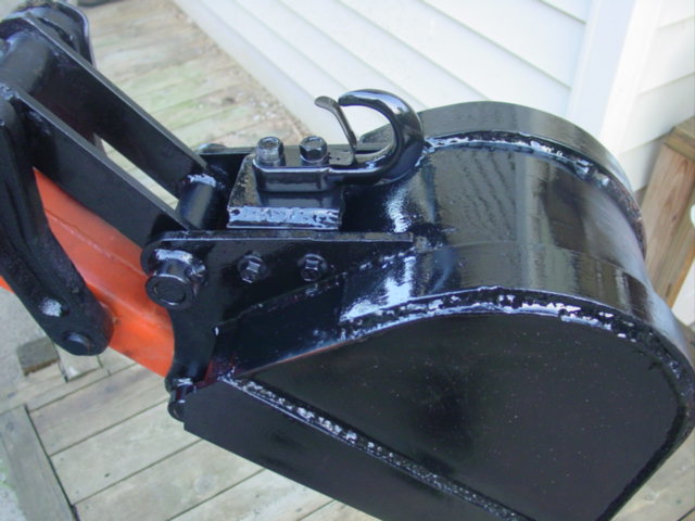

Here is a pix of the hook I put on my backhoes bucket, same technique, 1/4 plate welded to 1/4 angle side bolted into the bucket bracket 1/2 inch steels with Grade8 bolts.

reedfish1954,
I like the way you did both, but especially the backhoe bucket. I have been trying to think of how I wanted to put hooks on my buckets, and I may just do it the way you did.
Looks real good.
Was there a reason you did not just weld the hook on the bucket? I had not thought of doing it otherwise until I saw your picture...
   / FEL Hooks #9
Welding on a backhoe bucket can be tricky business. I can't speak for our small buckets, but the buckets on construction machines contain special steels.
With those steels, you CAN'T just weld it. Usually a pre-heating, welding, followed by post-heating is required. I've seen cases where a weld was laid down on a bucket and before the bead was finished, it already had begun to crack back at the starting end. It opened up just like a zipper...all by itself too!
Don't get me wrong, any of us can do it. We must just keep in mind the type of parent metal were working with and work accordingly. I've only done a little work on these.
Maybe someone in our community has a lot of experience with welding these buckets and can create a detailed procedure for us to follow. Then again, if someone can tell us what steals these various buckets contain, then maybe we won't need to worry.
