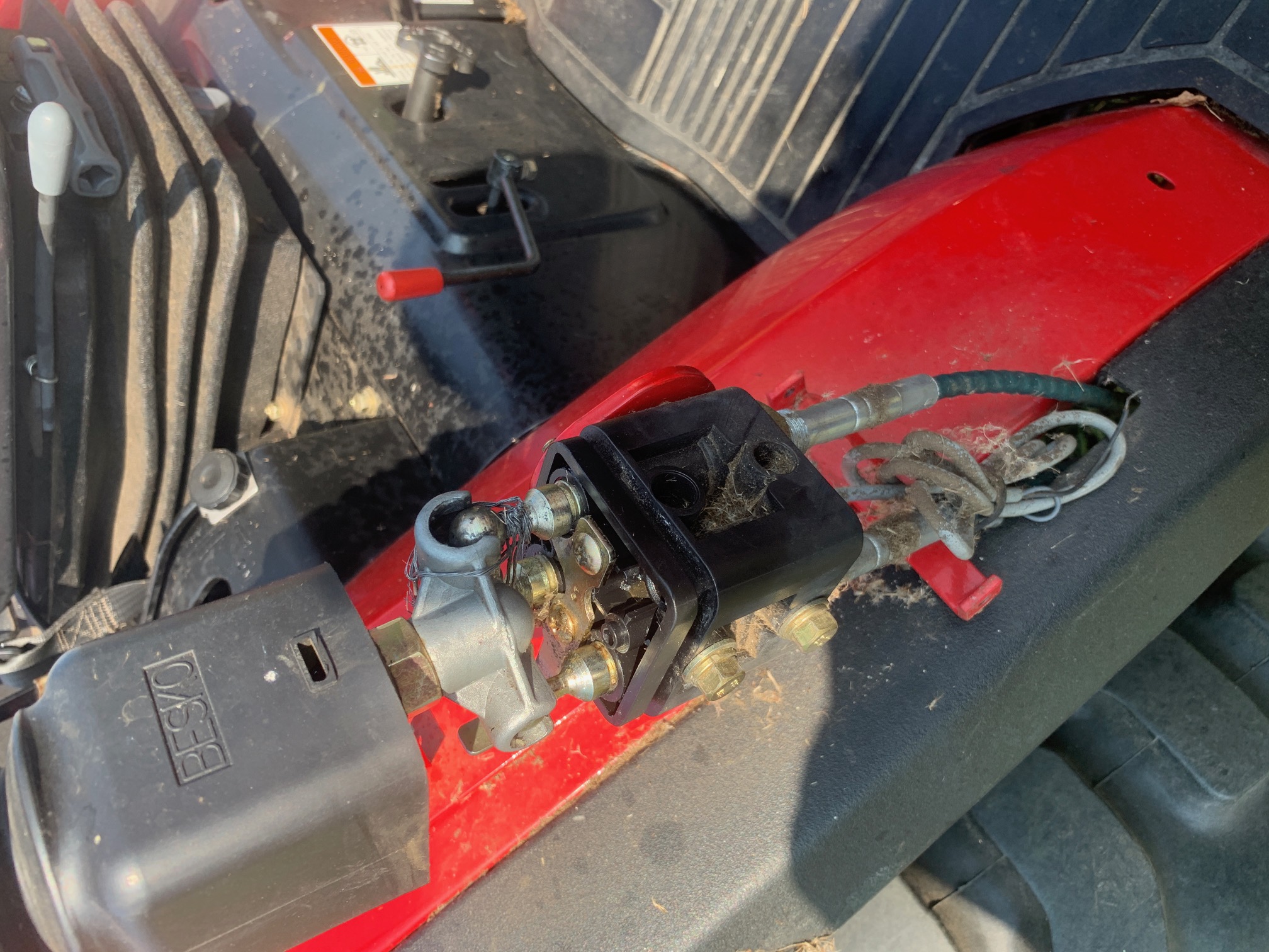

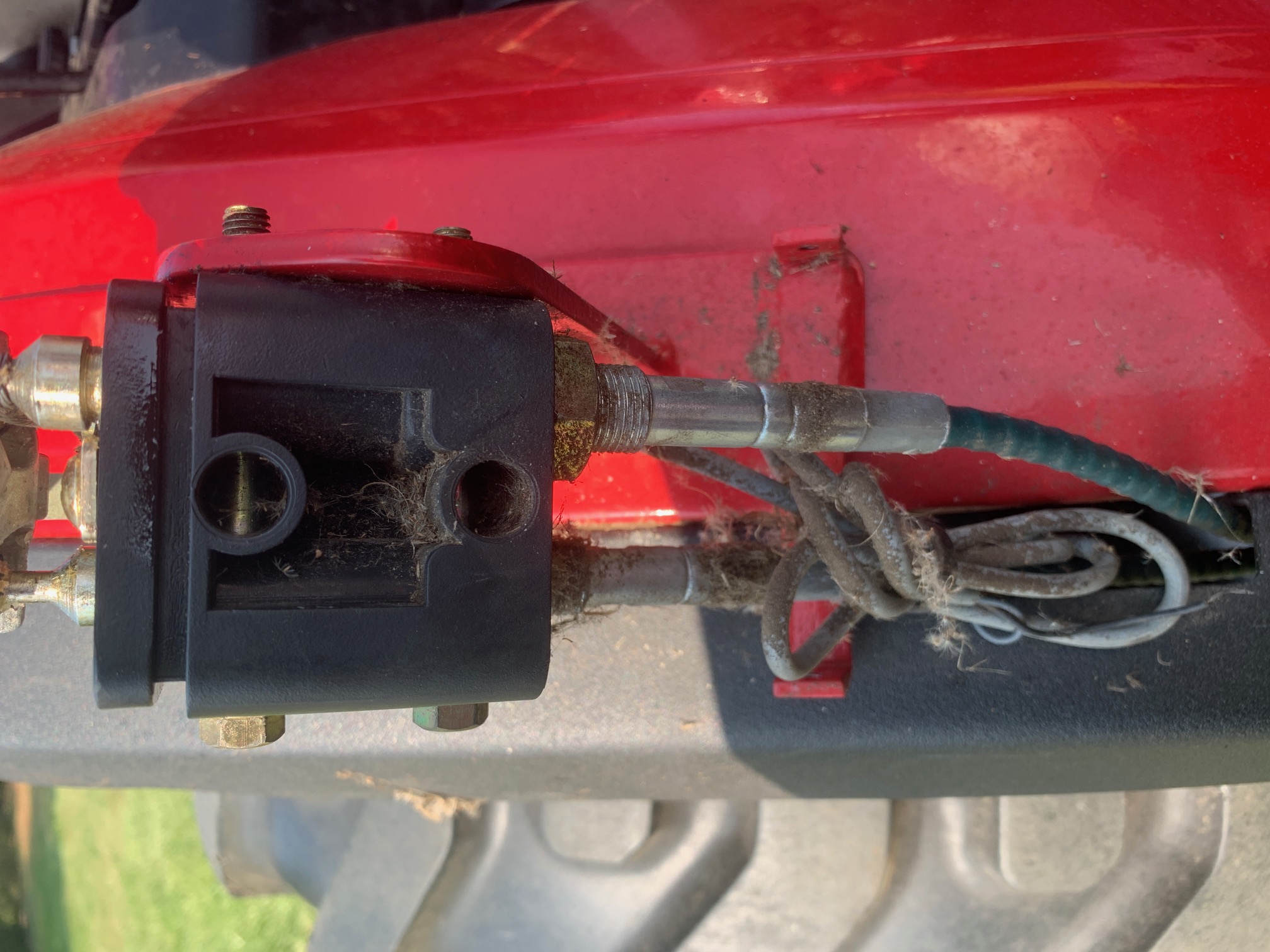

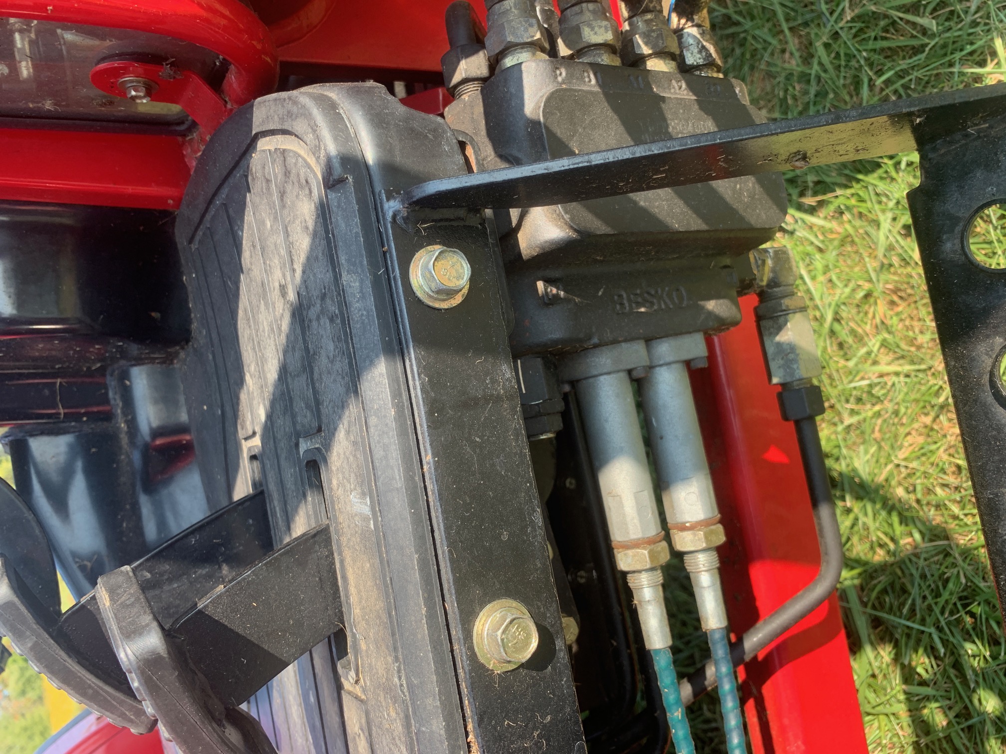

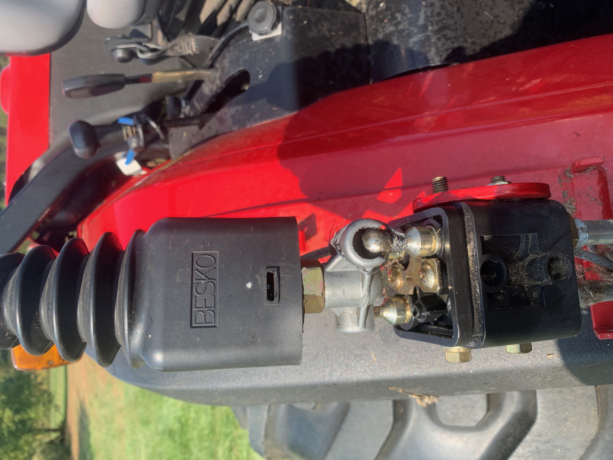

pictures are of a BESKO Joystick on a TYM 353HST.
the Ball will not stay in upper triangular part --
can i just replace joy stick "BOX" via two cables ? Is this pretty standard --any JS will work ?
what specs do i need to know when replacing ? nearest TYM dealer is over 100 miles away --
any help will be great !!
thx
bob

Looks like others on this forum have had issues with besko loader valves similar to yours. Enter besko in the search forum area to read their stories. Might want to contact tym dealer with model number of your valve to get correct parts the first time.
   / FEL i know nothing --what do i need to replace the joystick #3
The triangle piece is probably the problem. I would contact dealer or maybe Besko and order that part. When you replace it put some grease on all the moving parts.
Yes, you could use a different joystick but getting one to fit without modifying the mounts will be difficult. Also you have to make sure the orientation is the same. Otherwise the controls would be backwards. The simplest solution is fix the one you have.

Short Line Parts Repair Part - Joint for NIMCO Koyker and Westendorf Joysticks Parts for Koyker Front End Loaders - Joystick Kits
It's for a Koyker but some people have reported that Shortline is helpful and some Koyker parts fit Beskos.
Here' a video (from the same company) showing how to work on the joystick assembly:
How to Replace Parts on NIMCO Joystick - Cables, Pivot Ball Pin, and Triangle Joint - YouTube
that Nimco she's working on looks a lot like our Bescos. I wonder if that would work as a replacement joystick for Besco? You could ask Shortline.

thanks --- i got one ( stainless steel) from Kioti dealer ---
