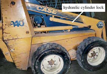

Down unless you have a physical cylinder lock to keep the loader arm up and in the air no matter what.
See below for an example of one:

Leaving them up can kill somebody!!
HEAVY weight suspended. Sometimes things break. Then heavy thing falls ... possibly extremely fast :(
