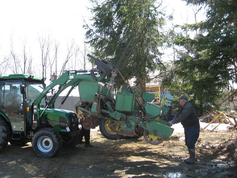

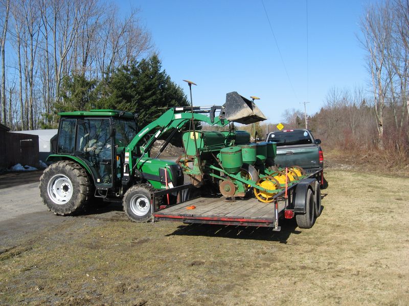

I know they come from the factory a little on the low side I had my dealer turn mine up a little. I am not sure what he did, but he said that that is a bolt or a set screw somewhere under the tractor that you turn to increase your lift capacity.
I am not sure how much my tractor can lift but I have unloaded a pallet of wood pellets that weights 2000#'s. And have lifted my old JD 494 4-row & 1240 4-row corn planters off my trailer no problem. Not sure of the weight of them, but I am sure they arent very light.
My guess is your lift capacity is adjusted a little on the low side and/or you had more weight on the tongue of your trailer than you thought.
