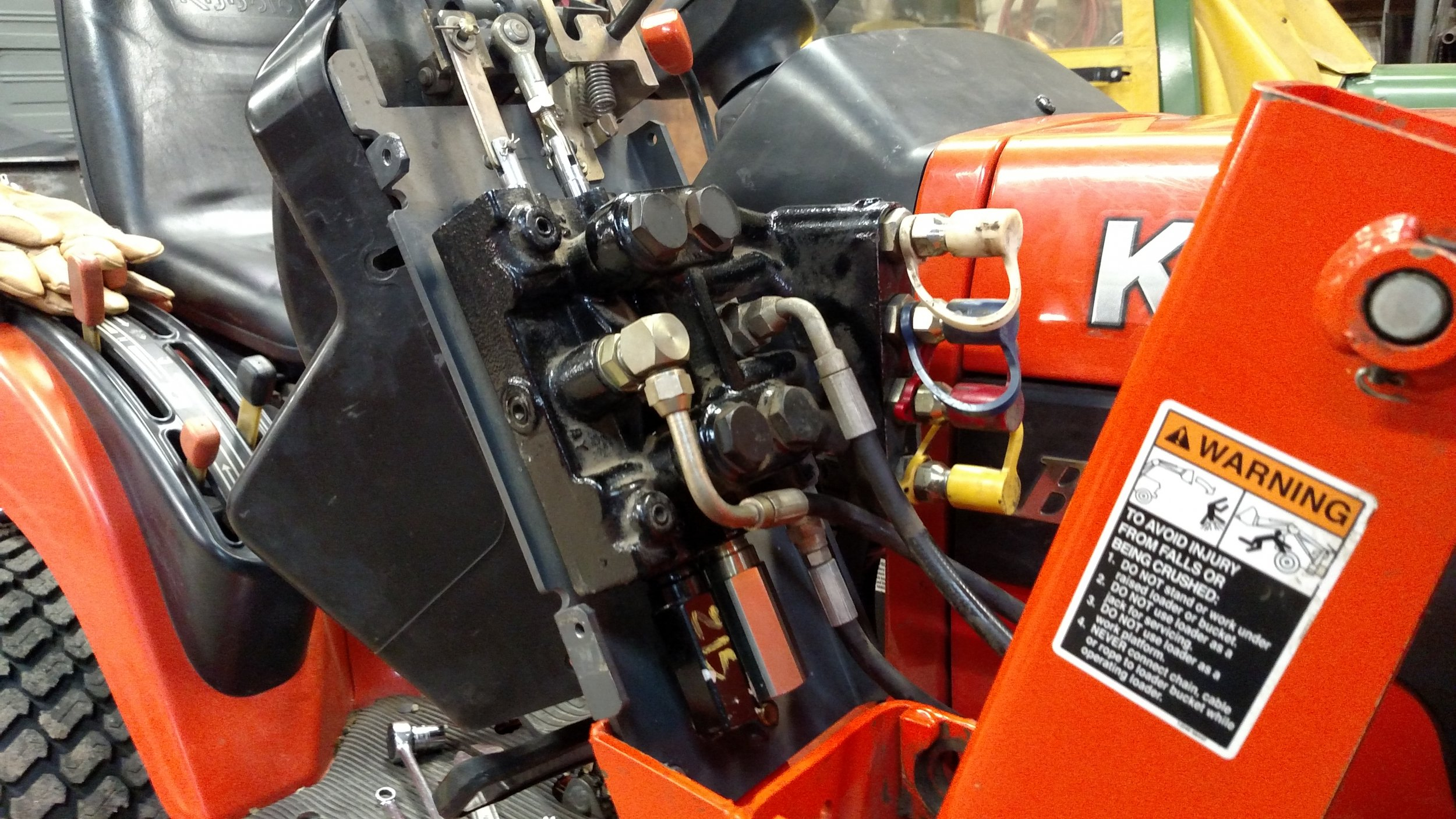

Looking for a picture of the valve body showing the hose connection ports and where the hoses run .
The bottom 2 hoses had to be replaced & hose 4 that disconnects from tractor & feeds the FEL.
I removed the valve from tractor with the hose connected, took it to a local dealer that made 2 new hose made , brought it back it was very difficult to in stall because it was a tight fit.
After the installing the tractor FEL did not function correctly, called the dealer and they said I had a hose hookup wrong .
The FEL hoses were tag from the factory 2 hose are red , 2 hose are blue , 2 hose are white , 2 hose are yellow all had a quick disconnect simple right ?
or so I thought ,the only hoses that was replaced are there , I do not know if they moved the other hoses to replace the new ones , they said the hoses went back where they were removed from or so they thought

Don't know if this will help, but here is a picture of the valve and hoses on my LA211.

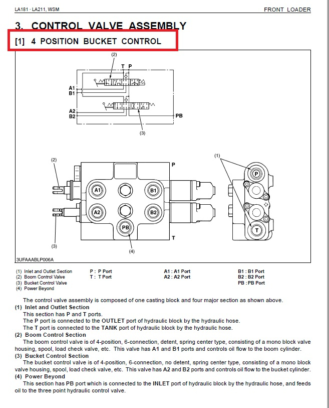

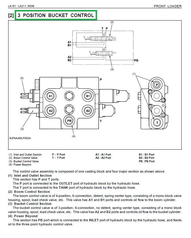

There are two styles of loader valve controls. A 4 position bucket control and a 3 position bucket control.
You need to figure out which you have because copying someone who has a different valve than you do wont work.

You also need to find and then study the hydraulic block outlet type on your tractor.
Start by looking for letters cast into the valve body of your valve beside its ports.
I am with your dealer in thinking you have hoses in the wrong place. Sadly this is a not uncommon occufrence.
