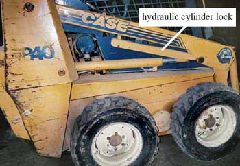

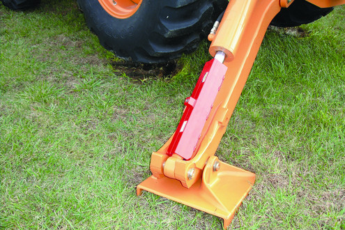

What I usually see is a channel or angle iron clamped to the exposed rod to prevent retraction.
Bruce
Bruce
Thats what I do. Angle iron and a few hoseclamps to hold it on

Ah ok, so a piece of 2" angle iron layed on top of the exposed rod end would do it, with perhaps a couple hose clamps to keep it in place. I get it.
One side enough or should I do both sides?
Thanks,

The "strut" on the lift cylinder is the OSHA Approved device. I would NOT use wood at that location. ;-)
eta
The Allied loader on the Hurlimann is placarded with instructions and warnings for the use of the swing in cylinder strut safety supports.
But the devices themselves are not fitted. I wish they were from time to time.

Hose clamps under potential stress make me nervous. I would use a couple of hardware store U-bolts instead.
Bruce
   / FEL lock/support when working on the tractor? #8
Bruce
The hose clamps are under no stress. (unless you cut the ends of the angle iron crooked).
The hose clamps are only there to hole the angle in place. Once it has taken the load of the loader, the arent gonna move
