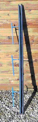

Should be nearly summer here, but we just got about 8" of snow. Tried using the new tractor and loader to clear the drive and managed to take a fair amount of gravel up along with the snow.
Heard about mounting a piece of pipe in front of the leading edge of the FEL to minimize this (sort of like a tooth bar in reverse) cutting.
Any help on the effectiveness of this and or details on how it is done.

When I plow on gravel with my truck I install the shoes. It is basically the same thing if I understand the concept you describe. You will end up with a layer of snow (same thickness as the pipe OD) and a skid mark for each piece pipe that spaces the FEL bucket off the surface.
this will work well on reasonably packed gravel

I normally use the back blade to plow, but when I need to use the loader, I curl the bucket up slightly (an inch or so is good), then drop it down and in float (mostly). That picks up the majority of the snow, yet doesn't pick up the gravel.
You'll have to experiment a bit, but I think that technique will work for you...
Of course, don't forget dragging the snow back with the cutting edge of the bucket works very well too. Just curl the bucket so the bottom is almost 90° to the ground (actually, 75° to 85° works better), then put 'er in float and pull the snow back.

the idea I saw on another board was this : /forums/images/graemlins/confused.gif

Malibu,
The pipe is split to fit over the cutting edge. I hear that it works very very well. The pipe lets the point of the blade slide over imperfections in the pavement and or gravel.
