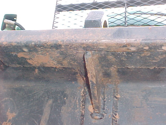

I have a JD 4500 with 460 FEL. I bent the top of the bucket (doing something stupid). I am thinking of welding (and hopefully straightening the bucket) a piece of 3" c-channel to the top of the bucket. I have seen others with hooks,etc. welded on the top of the c-channel. Does anyone have any suggestions? Looking to strengthen and increase the utility of the FEL.

Here is a pic of my bucket. The photo is a little disorienting. It's taken from the front of the tractor, looking into the bucket, and looking up to the upper lip. You can see some flat bar welded to reinforce the center. Steel rod or pipe welded into the recess of the lip would help too. I have pulled logs out of a pile with a chain hooked to the top of the bucket with no bending.

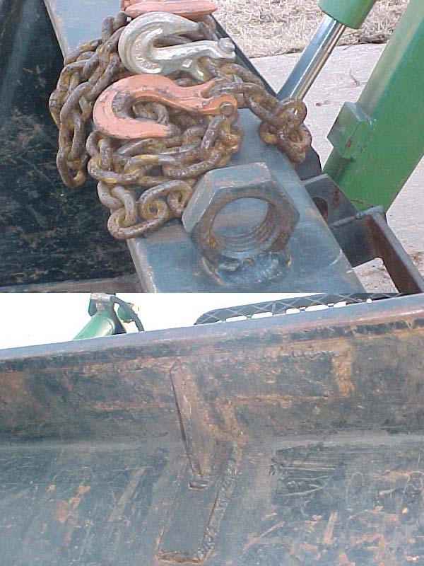

Is that a large nut on top? Is it used to pull a chain through? Where did you get something that large? Does the plate welded in the center of the bucket interfere with anything?
I was going to weld plates on the sides of the bucket as well. The top of the bucket has actually split due to the bend and continued use.

<font color="blue"> Is that a large nut on top? Is it used to pull a chain through? Where did you get something that large? Does the plate welded in the center of the bucket interfere with anything? </font>
Here's a picture of the nut (also a better(?) view of the welded reinforcement). The nut was my first tractor welding project, about 4 years ago. At the time, I knew nothing of TBN or Tractor Supply Co. I also didn't know that weldable hooks were the standard. My little brain had to think pretty hard to come up with the "nut" idea. I kind of laugh to myself when I look at it now. But it works just fine. It was steel yard scrap at 15 cents a pound. I have a chain with a slip hook on each end and a grab hook a foot or so from one end. I use a slip hook on the nut and take up slack with the grab hook. The flat bar welded in the bucket doesn't seem to interfere with anything.
All the suggestions you've gotten are good ones. If you reinforce the top of your bucket with channel, rod, angle iron, flat bar or...??, I think you'll find your bucket will hold up well.

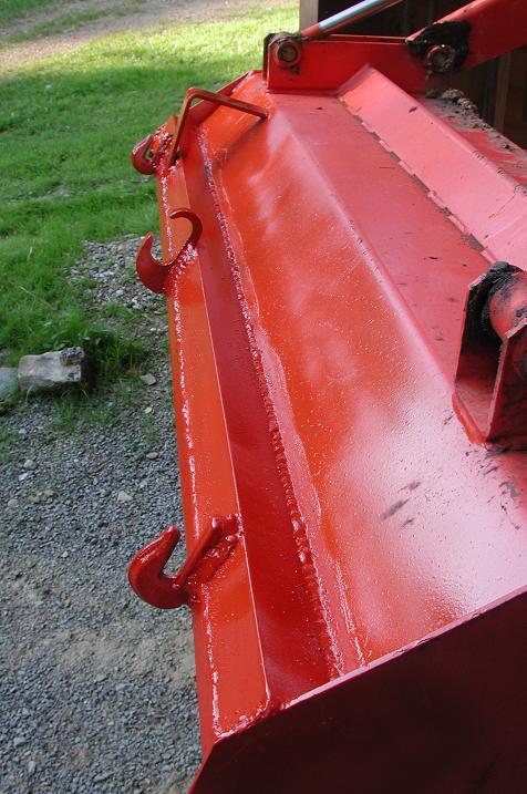

I used a piece of 1/4" angle and welded a slip hook in the middle and grab hooks towards the ends...
This setup works well. I could have stitch welded the angle, but wanted the practice running the beads... /forums/images/graemlins/smile.gif
Hooks rank right up there with a tooth bar for usefulness. Be sure to add them, you won't regret it!
