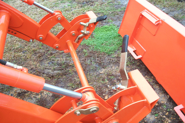

I've got a Kubota 3800 with a SSQA FEL. I was moving some brush around a few weeks ago and some vines got wrapped up around the QA levers and released one side of the grapple. I hooked it back up and went about my business. I had palette forks on this past weekend and noticed they weren't entirely level and got to looking more closely. It doesn't look like any metal is bent or anything but one side has about 1 or so inches more of the forward most polished hydraulic ram exposed than the other side which makes that side of the QA plate tilt forward a little more than the other side. I know next to nothing about hydraulics but is this something easy enough to adjust/fix or do I need to have it trailered into the Kubota dealership for them to take a look? Thanks for any suggestions and FWIW, I'm going to drill holes in the QA levers and chain them down so that doesn't repeat.

The cross tube part of the ssqa is probably twisted. I had more or less the same thing happen to me. Did the forks attach easily or was one side a PITA?
Take a good look from one side to the other, with no attachments hooked up, at the top edge of the ssqa (the part that goes up into the bucket). At first we could barely tell but with a 4' level across them it was apparent the tube was twisted.
I continued to use mine until one side finally broke off, then welded a solid 2' cross bar into a donor qa and everything is good.

Its not a tire pressure thing, you can easily see the QA plates are not aligned. The palette forks were a little difficult to get to attached on one side actually. I won't be able to get back up there until this weekend but I'm going to take a closer look with a level and see if I can tell exactly where the problem lies. I was expecting to see something really bent but it literally just looked like one of the hydraulic rams was out a little further so I thought I got off lucky. I've got a service coming up so I may just have to have them deal with it then. I'm not too bad but I'm not sure it is something I should just ignore.

It just sounds to me like the QA torque tube is twisted.(the tube between the QA plates) And the QA plates are uneven.
Just twist it back straight, or cut the tube off line it up straight and reweld.
It is an easy fix

If it is just twisted a little, I would have probably charged $100 for setting it up, and $50 to twist it.
If it was a good customer, and I was not busy, I may have done it for nothing too.
