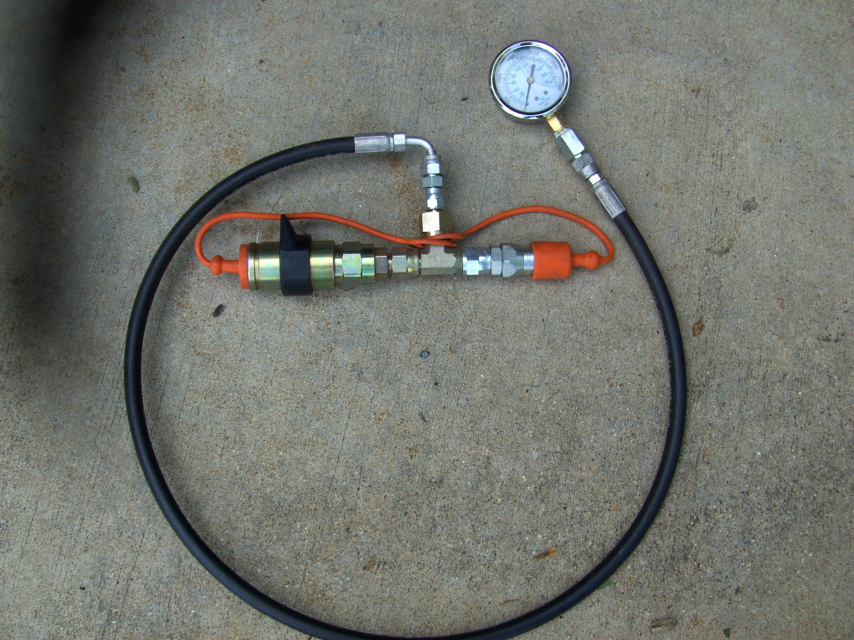

A restored FEL too me would mean that the cyl and valve meet the original specs for pressure and lift ability.
If you know what the QD's are, you can take a hyd gauge with you and check the pressure.
