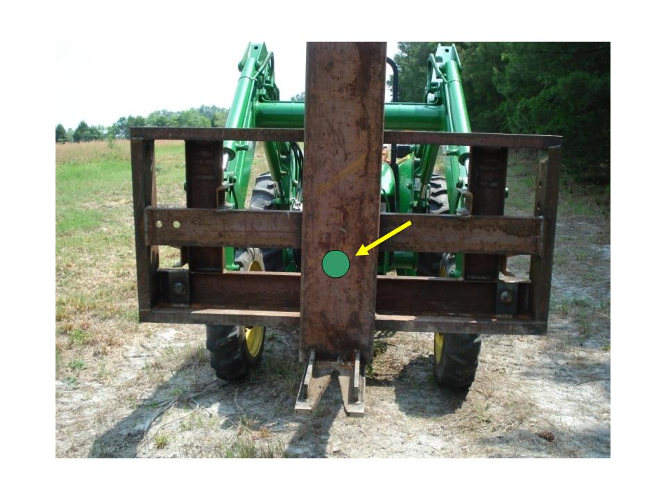

Here is a Tree Grubber that I built for my brother's tractor. He recently bought 25 acres and there are about 5 acres of small saplings/ pines/ scrubs that he wants to easily remove. I came up with this idea from TBN as well as pictures of commercially built units for skidsteers. The V plate is 3/4 inch plate, 4 inch opening at the wide end. The frame is mostly 5 inch channel. The next step is to sandblast it and get some paint on it. It took him an hour or so to get the hang of it, but he can zero in on one and up-root it fairly quickly, much better than a shovel and axe!
Sorry the pics came out in reverse order so you will have to start at the bottom of the pics and scroll UP to see it in action.
-Vinnie
   / FEL QA Tree Grubber I Built #2
Very nice.:cool: I bet if you added a viewport in the position shown in my attachment, your brother could stab every tree perfectly on the first try. I don't think it would significantly weaken the structure either.

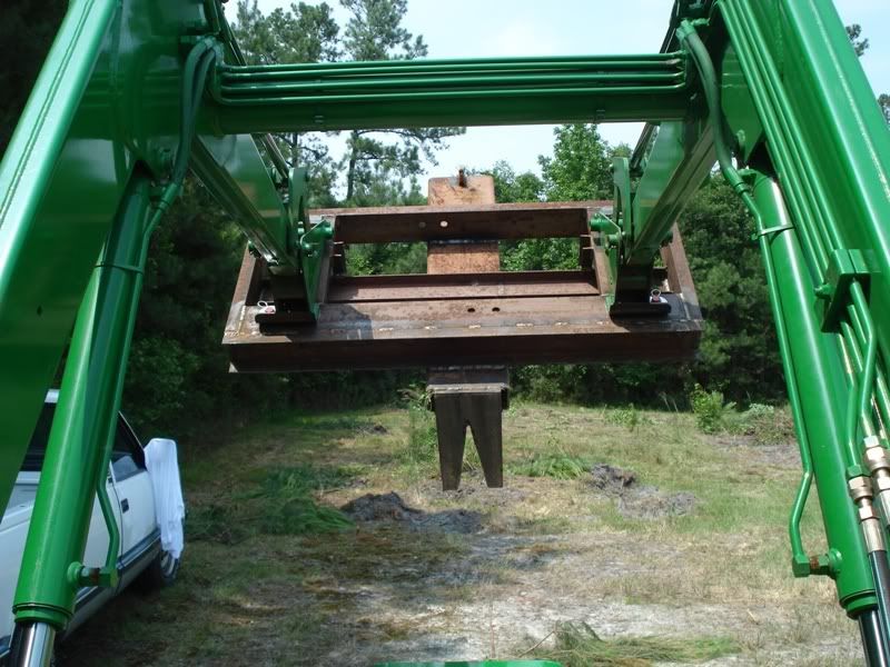

Thanks for the idea Jim! I'll mention it to my brother.
At first we had a front "sight" mounted at the top of the beam and he tried to line it up with the tree, but it doesn't take much of a twich on the steering to mis-align, so that didn't work too well. Next, I stood beside the trees and gave him directions and attempted to guide him to them, and that method was only about 75% successful.
After a few trees, he asked me to just stand back for a minute while he tried the current method. He raises the grubber and tilts it forward so that he can see the V plate. With the tractor steady moving forward in a creeper gear, he lines up the V with the tree and lowers the loader arms. Since he uses the same gear, and same rpm (idle) every time, he has learned to gauge it just right so that he can hit them on the first try about 90-95% of the time.
Here is a pic of what it looks like from the seat.
-Vinnie
   / FEL QA Tree Grubber I Built #4
Yep! That sure improves visibility. It seems like it would be quite easy to stab a tree, but it can be a challenge with the steering shift.
You've made a very useful tool for your brother. I hope he appreciates the work you've done. With all those little pine saplings, he will appreciate you more everytime he uses the grubber. I can see that being handy for grubbing up mesquite trees too. That looks like a very stong tool
