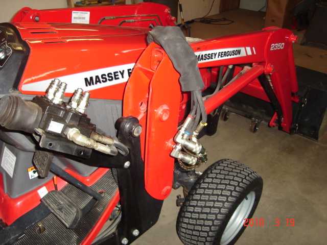

   / FEL Removal #2
Raise the loader, drop the legs(1 on each side), lower loader to the ground(keeping bucket level with ground).
Remove the 2 pins(1 each side on uprights back by loader controls. raise the back portion of fel arms out of the cradle using loader controls(you should be able to make them go forwards a little also to clear the cradle).
Shut tractor off, move loader control stick to all angles to remove pressure. then disconnect lines from loader control at the 'quick disconnects'.
Do this on a hard level surface(makes it easier), and keep tractor at an idle only while removing or installing FEL.
EDIT: If the loader sits in the sun, the oil inside will swell, causing pressure build-up that may make it hard to re-install the lines. If this happens, you can either push in on the balls in the center off the connectors, or loosen the connector a tad to relieve the pressure to get the lines back on. And before reconnecting the loader hoses, be sure to shut the tractor off and work control lever to relieve pressure there also.

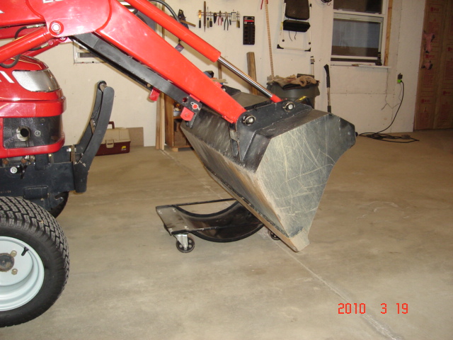

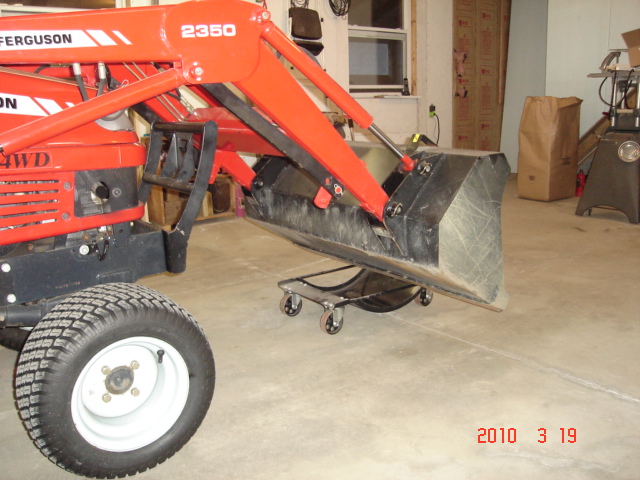

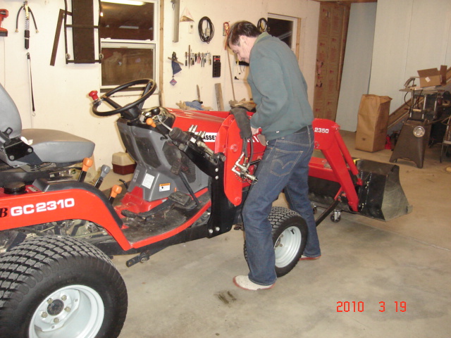

   / FEL Removal #4
I've also found that a flat dolly under the front of the bucket aids in removal (on a concrete floor).
With the "legs" of the FEL down and FEL lifted, I curl the bucket downward to around 45 degrees or so, then lower the front lip onto the dolly and shut off the tractor. From there, pressure in the system can be relieved as the bucket, with a combination of "lower" and "curl" can be lowered flat onto the dolly; the dolly will roll forward as this happens.
When all that's done, the FEL legs just touch the floor and all pressure is off the retaining pins, so they can easily be slipped out. Once the pins are out, I restart and use the curl control to rock the tops of the arms forward. This will put some strain on the hydraulic hoses, so be careful not to go too far. Shut off tractor, move controls around to relieve pressure, disconnect hydraulic lines.
At that point, I find it easiest to lift the FEL arms, one at a time, up slightly and out of their cradles so they rest just ahead of their normal positions, and then back the tractor up and away from the FEL.
With the dolly under the bucket, and standing between the two arms, I can then grab both arms, lift slightly, and roll the FEL/dolly to wherever I want it.
Takes longer too explain than to do....:thumbsup:
(Oops! You may notice that, for this "photo session," I had forgotten to lower the FEL legs first... learning the hard way!)
