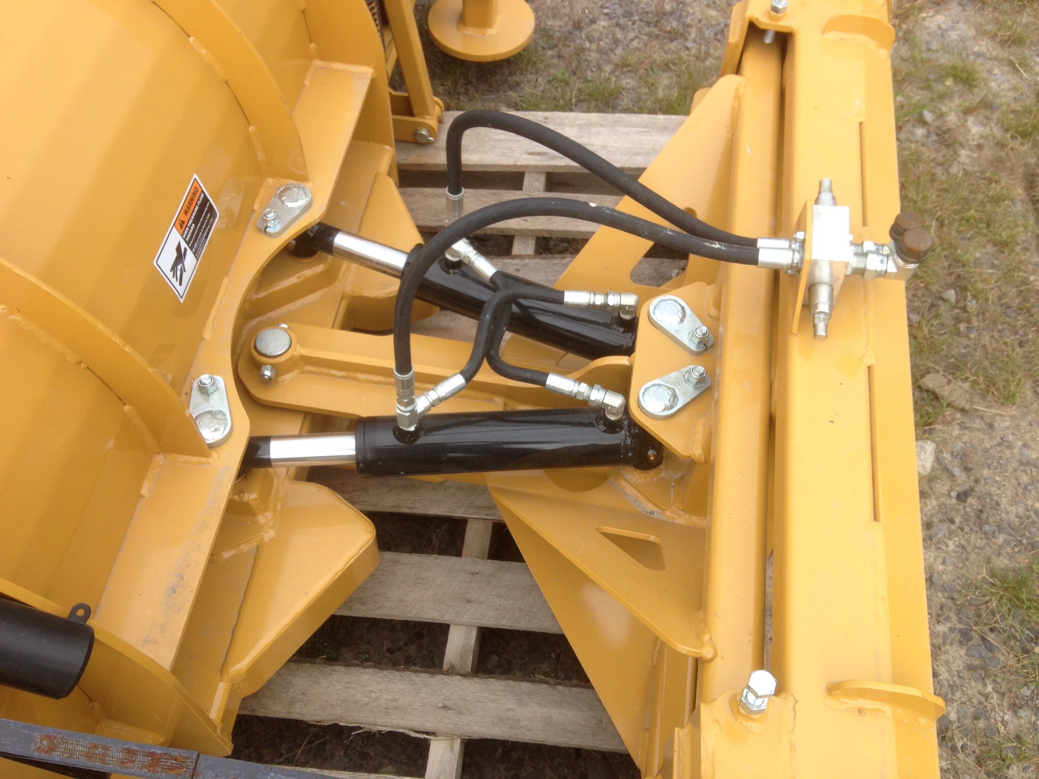

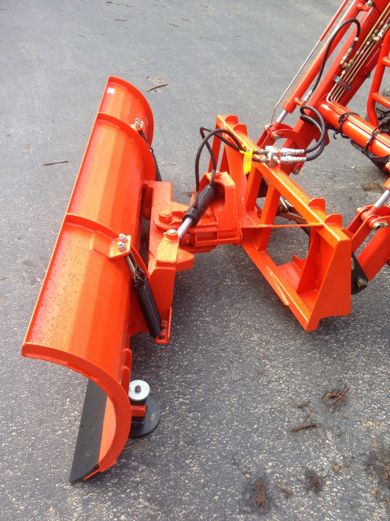

I like the HLA product line of plows. They angle their cylinders and make a very compact plow. The greater distance between the quick attach plate and plow face the greater your turning radius is and more likely the front end of your tractor will be pushed around.
They are also a true plow that rolls snow off the blade and come standard with a crossover relief valve. Lastly they all have lateral float that follows the contours of the drive. The orange one on my old Kioti is a 2000 series and the yellow one is a 3000 series on my current LS. I think the 2000 would be all you would need. Have fun and don't wait too long, winter's coming!
