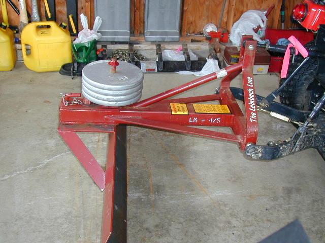

Anyway, I don't have a 2210, but the MF GC2300 is similarly sized. I have used the backblade / FEL combo quite effectively. Remember to plan your snowpiles so you have enough room to pile it over the course of the winter. In other words, you might push/pile the earlier snows back further to make sure you have room for snow later in the season.
Another thing I did was to have a welding shop weld a post for that would hold numerous weights onto my blade (see pic). It helps to prevent the blade riding up and over the heavier snows.
Good luck and have fun this winter!
