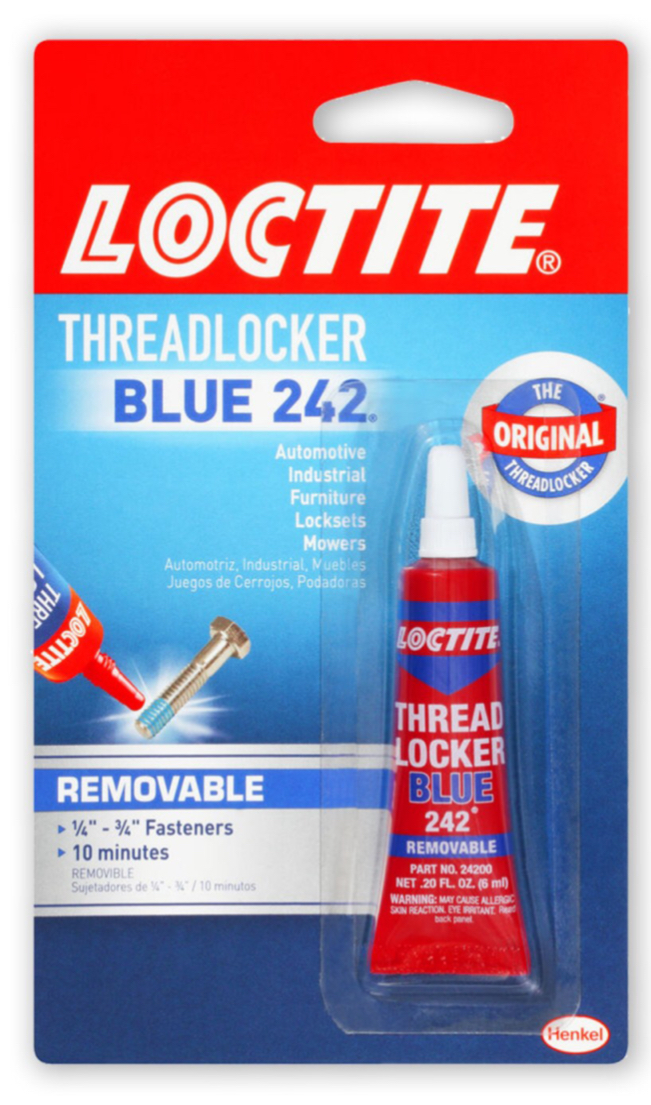

If you use thread locker - for God's sake use blue - Loctite 242 BLUE threadlocker OR Permatex PX 242 BLUE. The red stuff WILL require heat to loosen - the blue will not.
y that thinks the loctite packaging needs to be rethought out?
