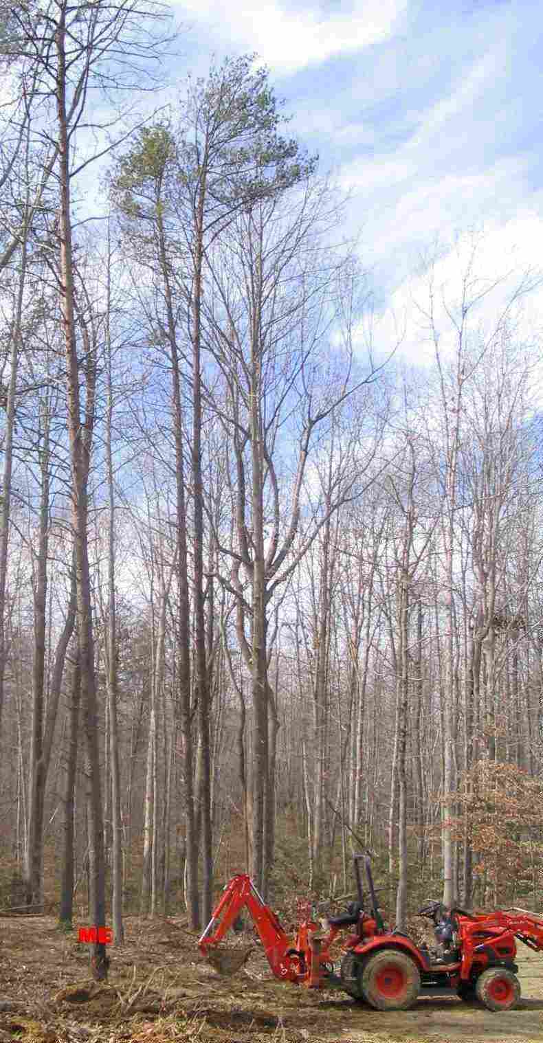

I did this tree in 15 minutes, but I got lucky and found the sweet spot right off the bat. Stumps can take twice as long! Here is the tree before.

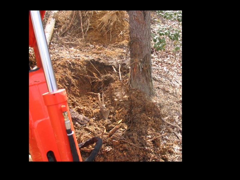

lol that didn't re-size very good, but sure made the tree look big lol, /forums/images/graemlins/grin.gif Anyway 2 important steps are 1) first dig is the direction ya want it to fall

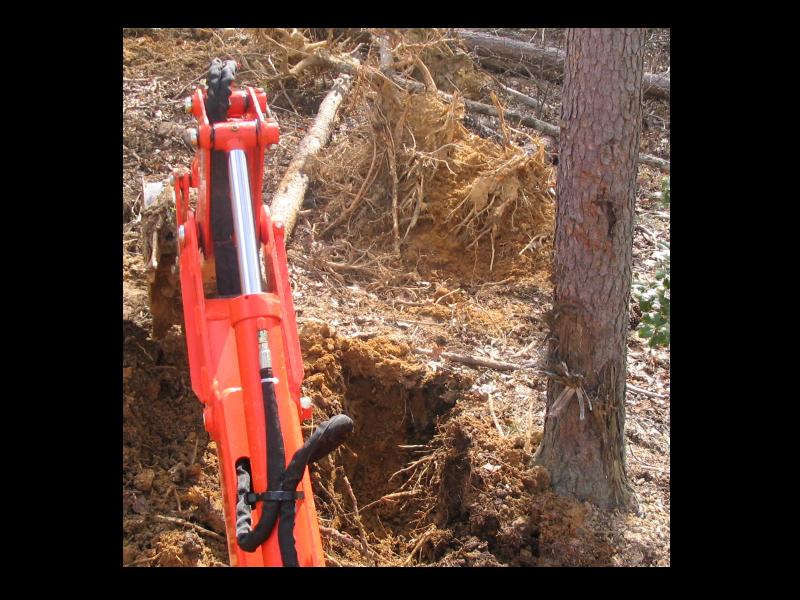

   / Felling a tree with a backhoe
dig

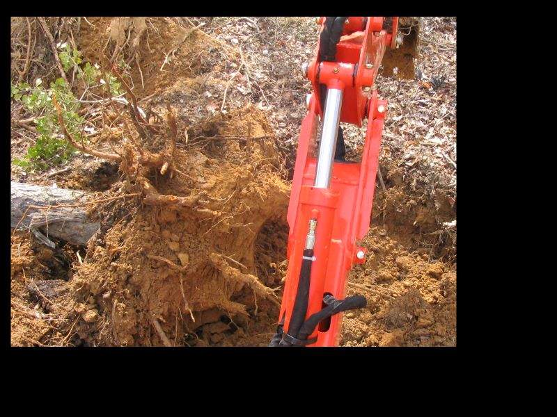

main roots snapped so pretty much done but better to be deep on the side you want it to fall

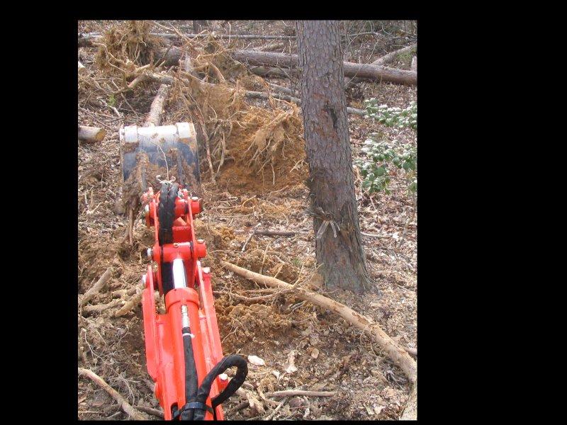

now to the opposite side and part 2 of the important steps... watch the tree!! Usally I can make them learn before they fall but I found the sweet spot on the second bucket and down it went. piece of cake

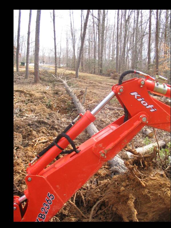

#9
another view

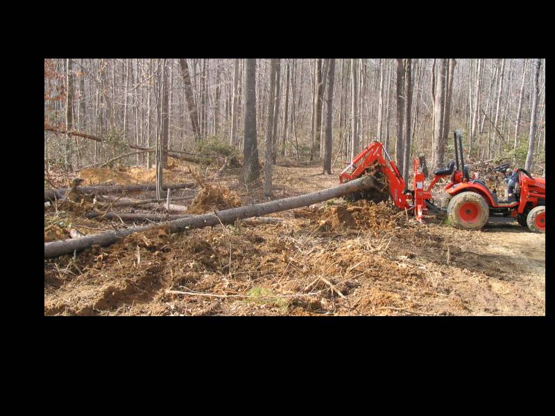

Then I move it out of the hole with BH
