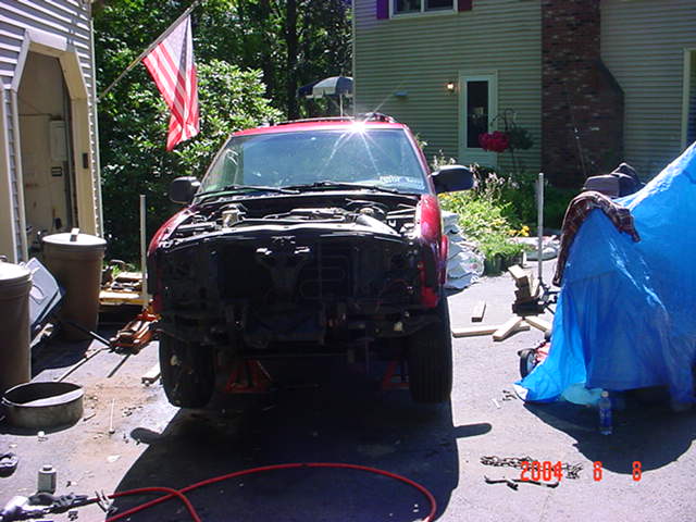

Saturday was change my truck's engine day. I decided to put in a new motor as the Chevy 4.3 was was getting tired. Instead of cleaning out my garage to use my chain fall. I decided to use the Cub 7275 to do the job. There is also much more room in the driveway than in the garage. I only wish that I took a picture of the motor going in or out using the tractor. I was just too dirty to even think of touching my camera. If you are wondering why I pulled the bumper and grille to change the motor? The tranny needs to be dropped out of a S-10 to change the motor. I have found that it is easier to pop off the bumper, grille, remove 8 body bolts and lift the front of the body up 4 inches and just remove the motor. This leaves the tranny and transfer case in the frame.

JimR,
Yep, does a nice job.
Just don't leave the motor hanging and expect it to be there very long (next morning?). You could end up with the motor sitting back in the car/floor/ground.
Hydraulic drift. Have used a 4x4 or similar with a notch to prop bucket up if you must leave it suspended.
BTW, an old tire makes a nice "seat" for a motor when you want to set it down...
-JC

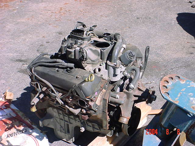

I was able to lower the motor in by myself with a few trips back and forth to make sure no wires or anything else got ripped or caught up. The newer motors have flat aluminum oil pans. All you need is a 6" tall board to hold them up nowadays.
