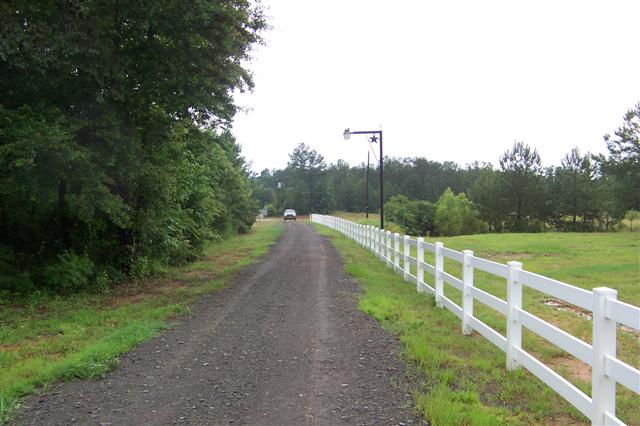

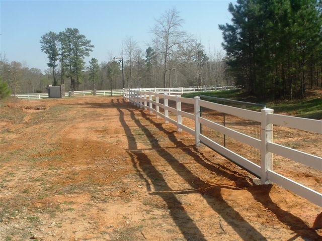

Pat,
When you say "vinyl slats" are you refering to a three or four rail fence? I'm putting in a vinyl three rail fence on my place and have a few thoughts on it.
Do you have the fence or know who you are buying it from yet? I shopped around and decided to buy mine from Gardner Fence Systems - Horse Fencing and PVC Fencing for $3.25 a foot. I bought 1,000 feet at the time and the tool to crimp the ends when you cut a rail. The tool was around $100 and they said they'd buy it back for that price when I was done with it.
My experience with vinyl fence started out about 15 years ago when my girfriend at the time had a horse and the people who owned the boarding facility put up vinyl fence there. It worked fine for keeping the horses in at first, but then the fence started to fall apart. They didn't set the posts very well and they moved. They added concrete and that helped, but the fence was also cheap, solid PVC and it got brittle. The last time I was there, it was in peices from either the animals, or something else.
I was very sceptical of vinyl fence after that and refused to consider it for myself for a very long time. Then I read about the new methods for making it and how they solved those strength and age issues by first creating the post from a material that isn't affected by the weather. I forget the name of it, but it's a gray color inside the posts. Then they put a white materail on the outside of the post to give it the white color. This bonding process is what you need to be sure to have when selecting a fence. Neither Home Depot or Lowes sell this type of posts. The rails are solid white vinyl with ribs in the middle for strength. I've never heard of them failing, it's just the posts that had problems.
I use a 12 inch auger with mine and also keep my clamshells with me when putting in posts. It's a trick to get the auger in the exact right spot and keep it there when starting it. I've found that using a shovel to start the hole before putting the auger in there gurantees that the auger wont wonder. The next problem is keeping it straight all the way down. If my wife is around, she'll watch to make sure nothing changes, but if I'm working by myself, it's very dificult to keep it straight on every hole. Things like roots and rocks in the ground will turn the bit and you end up with an angled hole. Once this happens, there's no way to straighten it out.
This is where the clamshells are so important. Lots of holes need straightening after they are dug!!!
From your other posts, I know you are a very detailed and precise person, so this might not apply to you, but I can't dig more then a few holes at a time without getting off course. I can measure out twenty holes, but by the tenth one, things have changed and I'm digging by hand to get the holes lined up and spaced properly again. When I work with Steph, we drill a hole and set the post one at a time. This way each one is exact and perfect with minimal fuss. When I work alone, I drill several holes and then curse myself for being in a rush!! hahahaha
I can't comment on your mixture for filling the posts as I just use clay to pack mine. About every hundred feet or so, I set one in concrete and fill it all the way up. They say to put two pieces of rebar in oposite corners first, then fill with concrete. I don't have any animals yet, so it's anybodies guess wether this is suffiicient or not.
Gates are something that vinyl fences really fall short on. From what I've seen, the gates made from vinyl fence are pure junk. The have a few variations of posts that you can use to make them strong, but none are realy all that great.
I discovered 5 inch square steel tubing that looks just like the vinyl posts when you paint it white. I weld on the hinges for regular farm gates and use them instead. The square tubing set in concrete is stronger then anything else out there and pretty much bullet proof for supporting a gate. Then to make it blend in with the vinyl fence, I screw three rails onto the gate. I line the rails up so they are level with the rails on the fence and cut them to the same size as the gate. Usualy 12 feet. From a distance, it blends in real nice. Up close you can tell it's a gate, but it's so nice that it's not a bad thing at all.

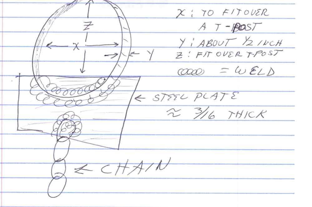

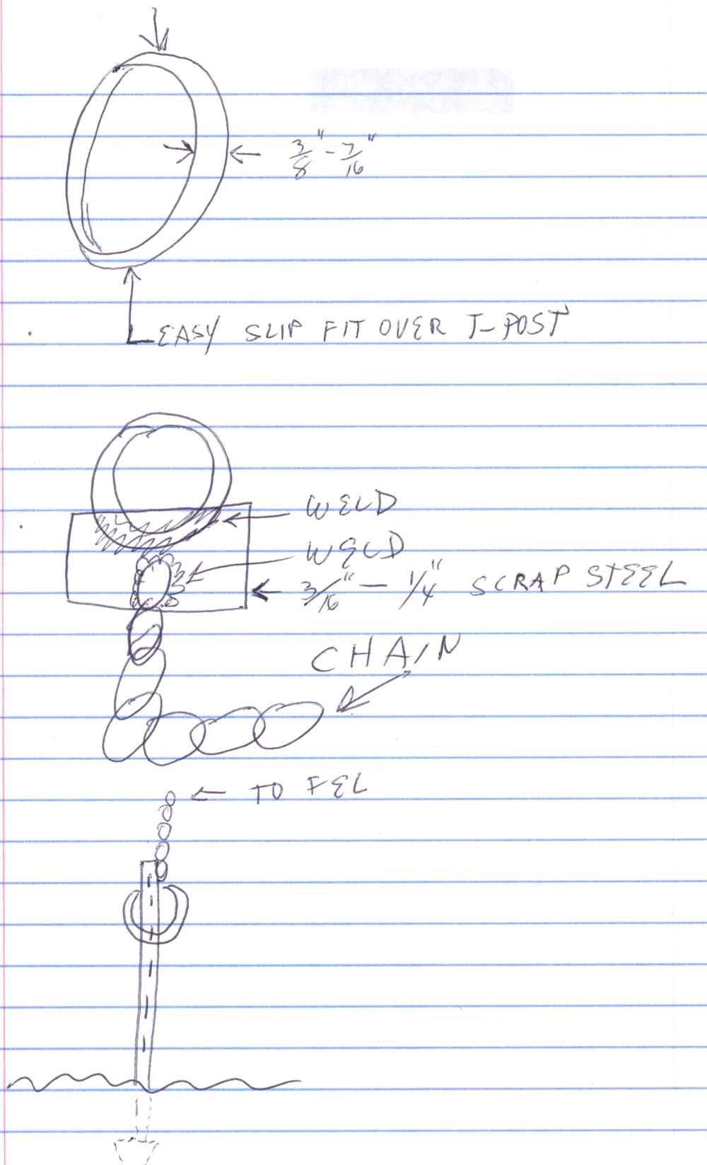

In anticipation of his coming I welded up a post popper. IT was made mostly from a scrap of pipe about a 3/8 inch cut off from a 4 inch HD steel pipe. You use it with the FEL and it worked super good till it broke. Snapped clean. Apparently my welding make the pipe brittle or more likely the water quenching did. I found a scrap of smaller pipe close to the size I really wanted. It fits over the T-post really easily but is probably less than 2 inch pipe (I didn't measure it.) I'll make a sketch and attach it to save trying to describe it so much.
In the sketch you see it is just a LARGE wedding ring looking thing. The pipe is about 1/4 inch thick and I cut off a piece about 3/8 to 7/16 in. I welded a scrap of steel to it to get better load handling than welding the chain to the ring directly and IT gives a little leverage to hold the ring tight to the post to engage the little lumps on the T-post.
In use you put the ring over the T-post with the chain side of the ring down toward the ground. When you take a strain with the FEL the ring cocks and will grip the T-post. It doesn't slip past the "lumps" on the T-post. It is way faster than wrapping a chain.
You don't want to use a long piece of pipe as it can't "cock" sideways under load and will slip off. If you make the ring too thin it will distort and get messed up under load too easily. This is my second design (what I intended in the first place) but didn't see the pipe I made it from the day I made the first prototype. If it isn't strong enough I will take another ring, slice through it so I can expand it and weld it over the outside of the "inner" ring making it thicker/stronger.
The dirt isn't really dry so the posts are coming out easily thanks to the FEL. If it were dryer it would be a tougher job. You then lay the FEL bucket on the ground with the cutting edge near the post, put the post popper ring on the post and attach the chain (with a hook) to the bucket and use curl to pull on the post. This is much more force than a straight pull.

Version two was made with smaller diameter pipe and NOT quenched in water (JUST HOW LONG DOES IT TAKE TO LEARN PATIENCE!!!!!)
The ID of the pipe has to be large enough, of course to let you put the thing over the T-post. The contact area between the chain and piece of pipe would be rather small since the "length" of the piece of pipe is so short (about a half inch on the second one.) So I use the scrap of flat stock to spread the load. I weld the scrap to the ring and the chain to the scrap. The ID of the pipe has to allow for the obstruction of the plate and still fit over the T-post.
In use the plate and chain side of the ring goes on the T-post first (chain side down.) You want to work from the "smooth" side of the T-post and if the ring slips a bit try again with a little lateral pressure to help seat the ring under one of the "lumps" on the T-post.
Your mileage may vary but this is way faster than fussing with wrapping a chain. If you are working alone you have to get off the tractor to put the ring on, pull the post up and drive to next post, get out of tractor, remove previous pulled post from ring, and put ring over next post.
It goes fast. Remember if you can't get enough force to pull the post with your hydraulics then put the bucket on the ground, hitch the chain appropriately, and use the CURL to pull up on the chain. (Like using a claw hammer to pull a nail.)
