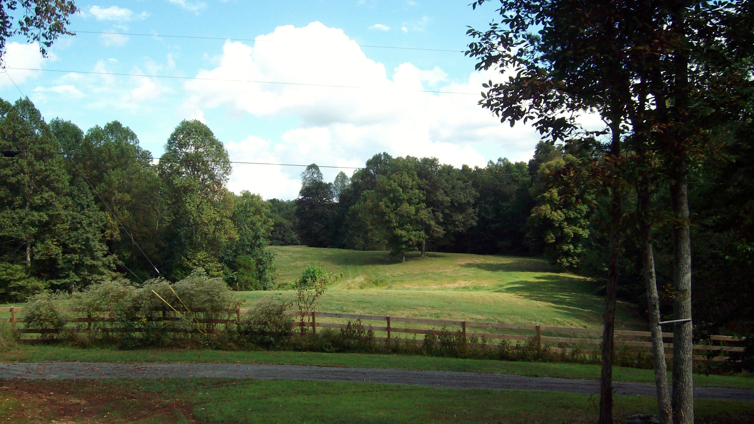

I had my BIL build about 400ft of 4-board fence for us. We used all PT pine for posts and 2x6 for the rails. It's been up a year now, so is weathered enough (and overgrown with weeds enough) for paint/stain. My dad used to LOVE using Cabot's creosote for fence parts - made them last nearly forever. Mere mortals can no longer get creosote, but I'm hoping that this will at least look the same.
Wolman™ WOODLIFE(R) CREOCOAT(R) Product Page
Apparently provides pretty good protection too. We'll be trying it out in a few days.
