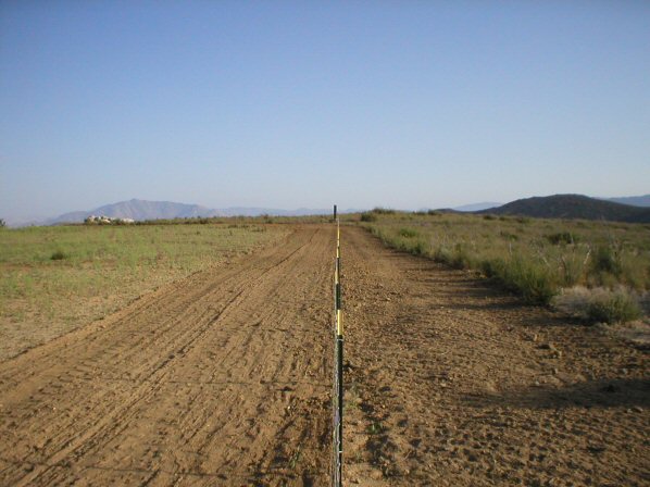

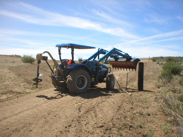

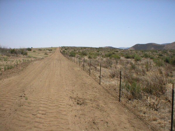

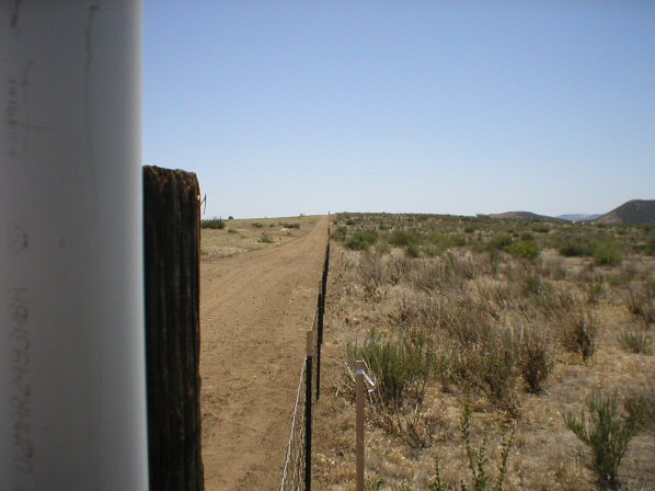

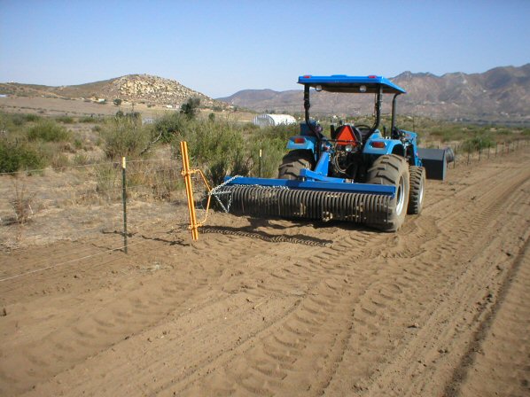

10' apart is what works for me. And I use my tractor with a fence wire clamp to stretch the wire.

   / Fence post spacing for box wire? #4
Nice pics Brian....Thanks for sharing.
