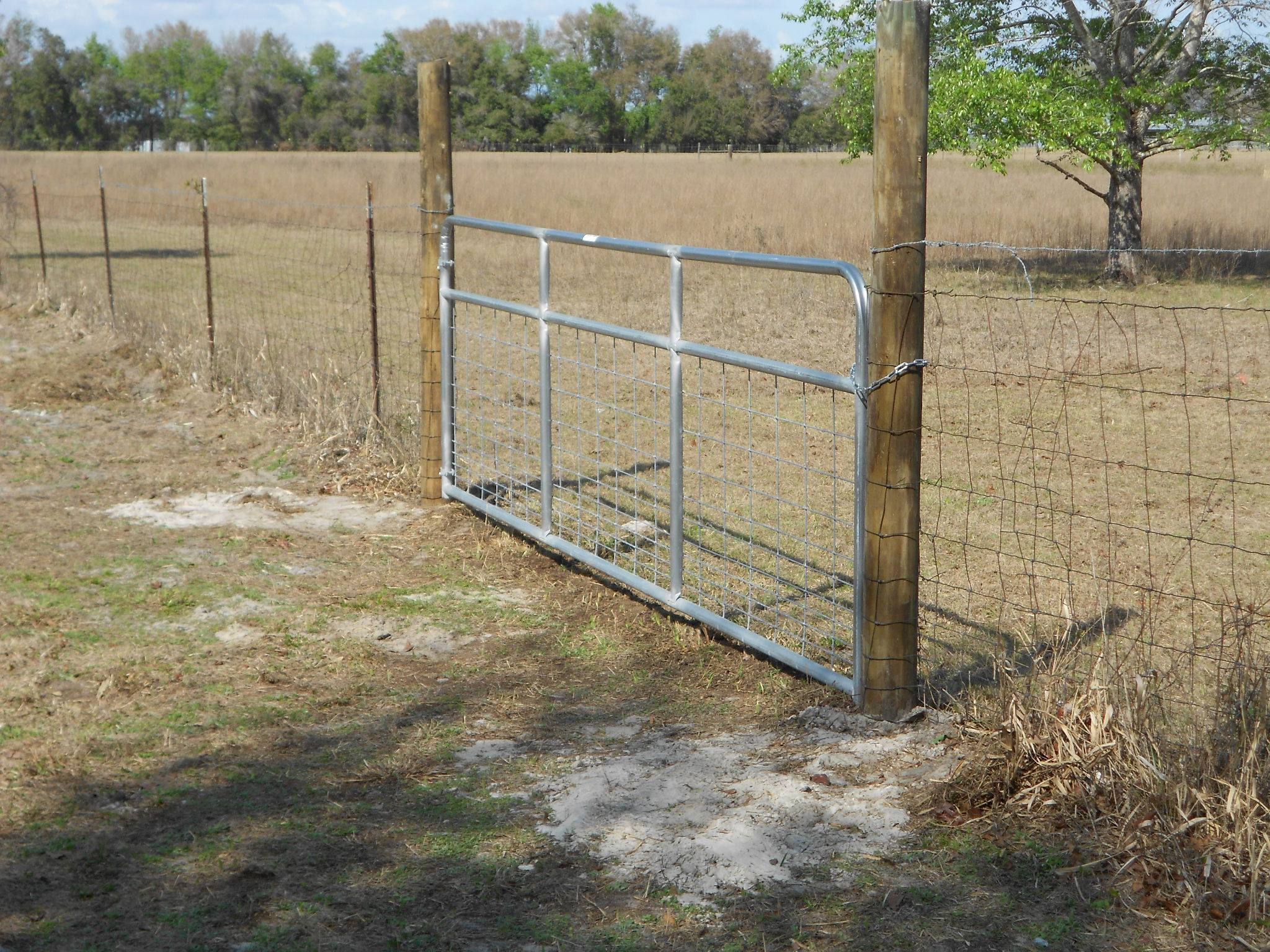

I just bought a 10 acre property and a neighbor told me they used to lease it and had about 50 goats on it with some horses.
In the pic I just added a new gate to the pasture and you can see the type of fence surrounding the pasture.

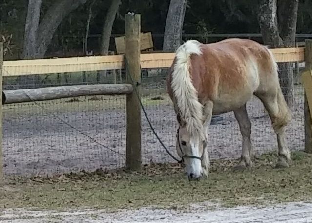

I am using no-climb, which has a much smaller opening than the field fence, topped by 1X6 boards and no barbed wire. On my field for the dogs, I did the same thing but used 5' high no climb buried in a trench to discourage digging under it. My neighbor has barbed wire and I've noticed all of her Horses have nicks in the necks I think are from the barbed wire.
This is the outside of the fence (I'm keeping one of my Halflinger's tied up to dry after his bath). The board are on the inside so that the horses push against them, and will be get treated once they've been allowed to dry a little. I'm lucky to have a fellow who saws the stuff exactly like I want it and the extra thickness (not to mention cost) is great.
