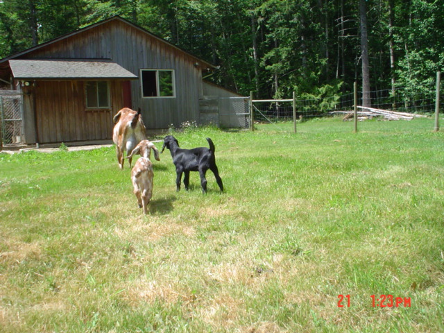

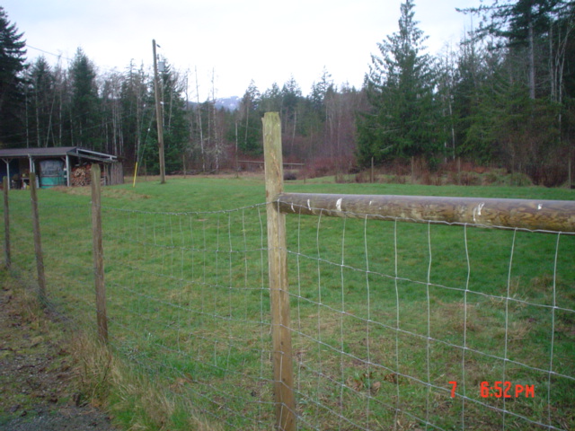

We use page wire for our goats. Not to keen on barb wire, would worry they could injure themselves.

   / Fencing for goats?
what exatcly is page fencing? It looks like regular field fencing. What is the spacing of the openings? Do you have any problems with goats sticking their heads through?
The spaces are smaller at the bottom. We call it page wire up our way, may go by other names in different areas. Yes, the goats can get their heads through it. Good thing as the grass is greener on the other side. :laughing::laughing: Our goats do not have horn so has not been a problem. If I had to do it over again I would look at a better "goat" wire fence. They do stand on it and rub against it so has become out of shape in a few areas. Having said that we have had goats for 9 years now and it is all the original wire.
