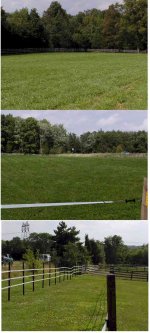

One of our pastures is a 4 rail (1" x 6" oak boards) wooden fence with an electric tape at the top. The 3 acres I just finished fencing uses 4 x 4 x 8s for posts with three strands of white 1.5" electric tape from HorseGuardFence . The corridor (170' long) I fenced in between our 2 pastures I used covered T Posts with the covers coming from HorseGuardFence.

But since I dont have his money or skills, I went with Redbrand "No Climb" with "T" posts. Each corner is braced and I have a Galvanized posts on the long runs to stiffen the fence up. I got some PVC caps to go over the top of the "T" posts so a horse does not get hurt.

Here's a picture of the fence project I completed this past Sunday. The bottom picture shows the covered T Posts. Enclosed area is about 3 acres.
