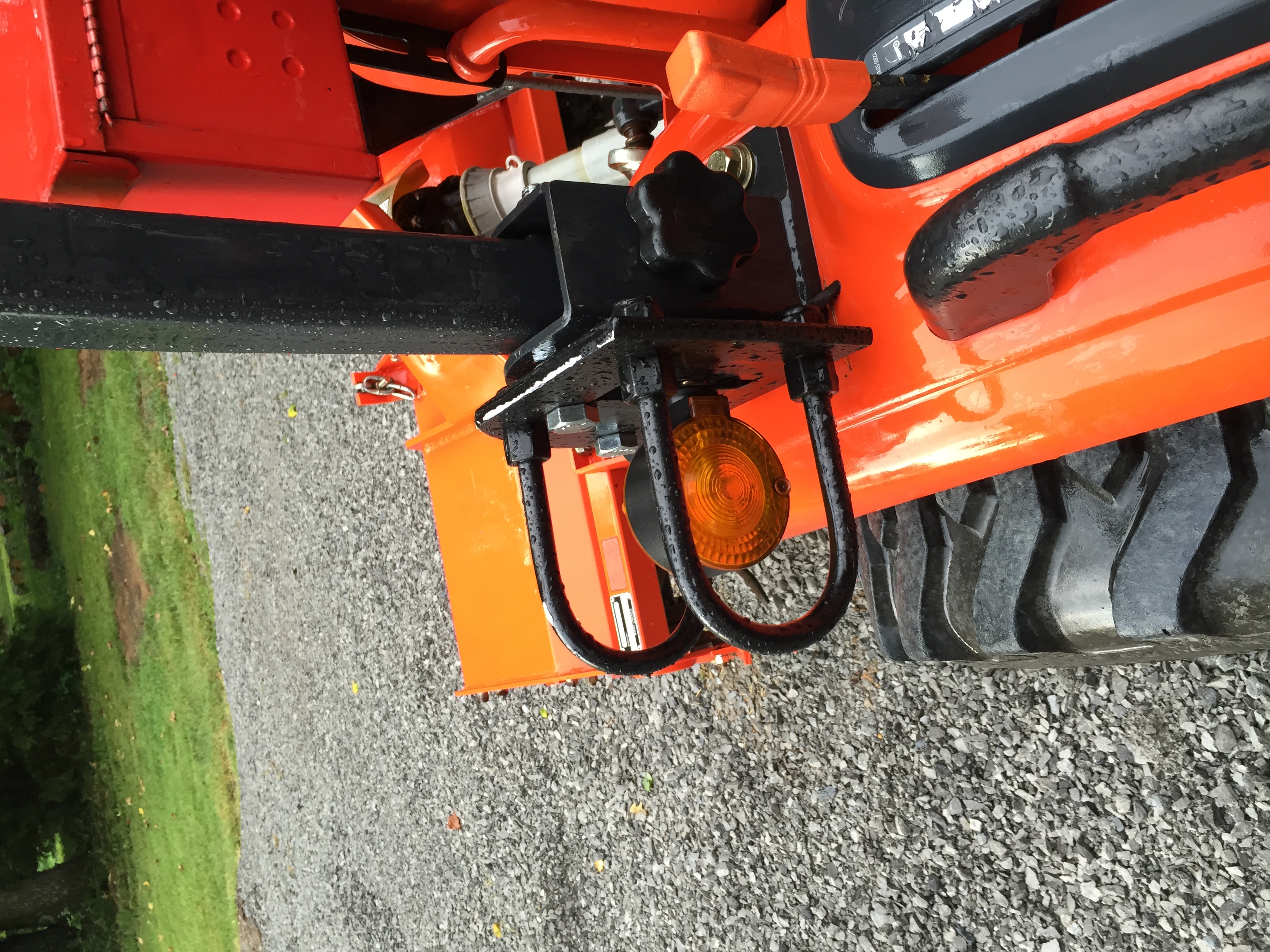

I thought what I had in mind would be easy to find. Not so much. I lost a lens from my fender flasher lights. With all the branches I run through it was bound to happen. Does anybody know of light guards available for the fender mounted lights on my Kubota L4740?

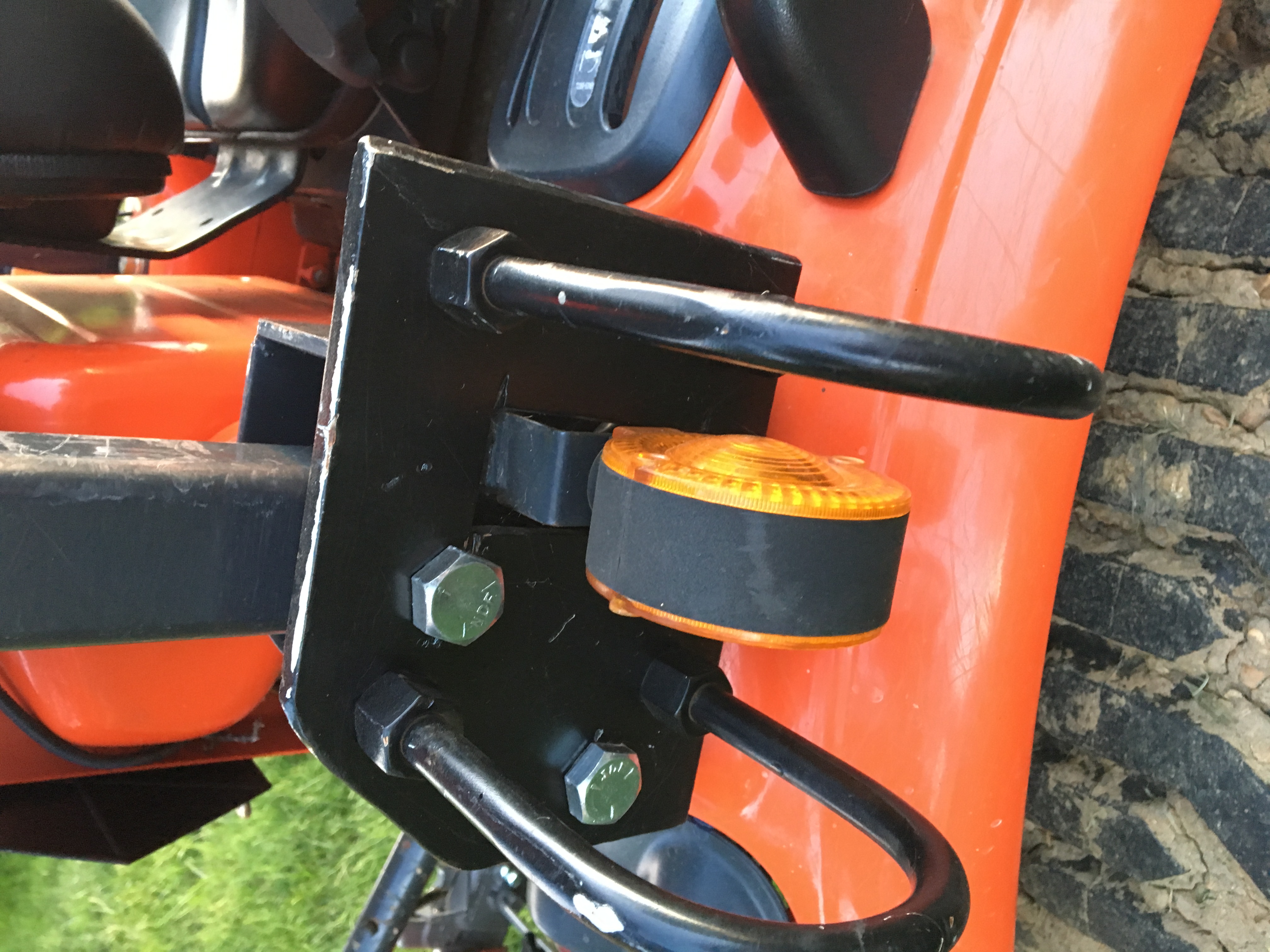

After I tore off the second flasher light on my Kioti I made my own. Took a 1/4" metal plate and drilled holes for U-bolts. Then mounted it to the roll bar. Will try to get picture tomorrow.
It also makes a great hand hold for getting on the tractor.

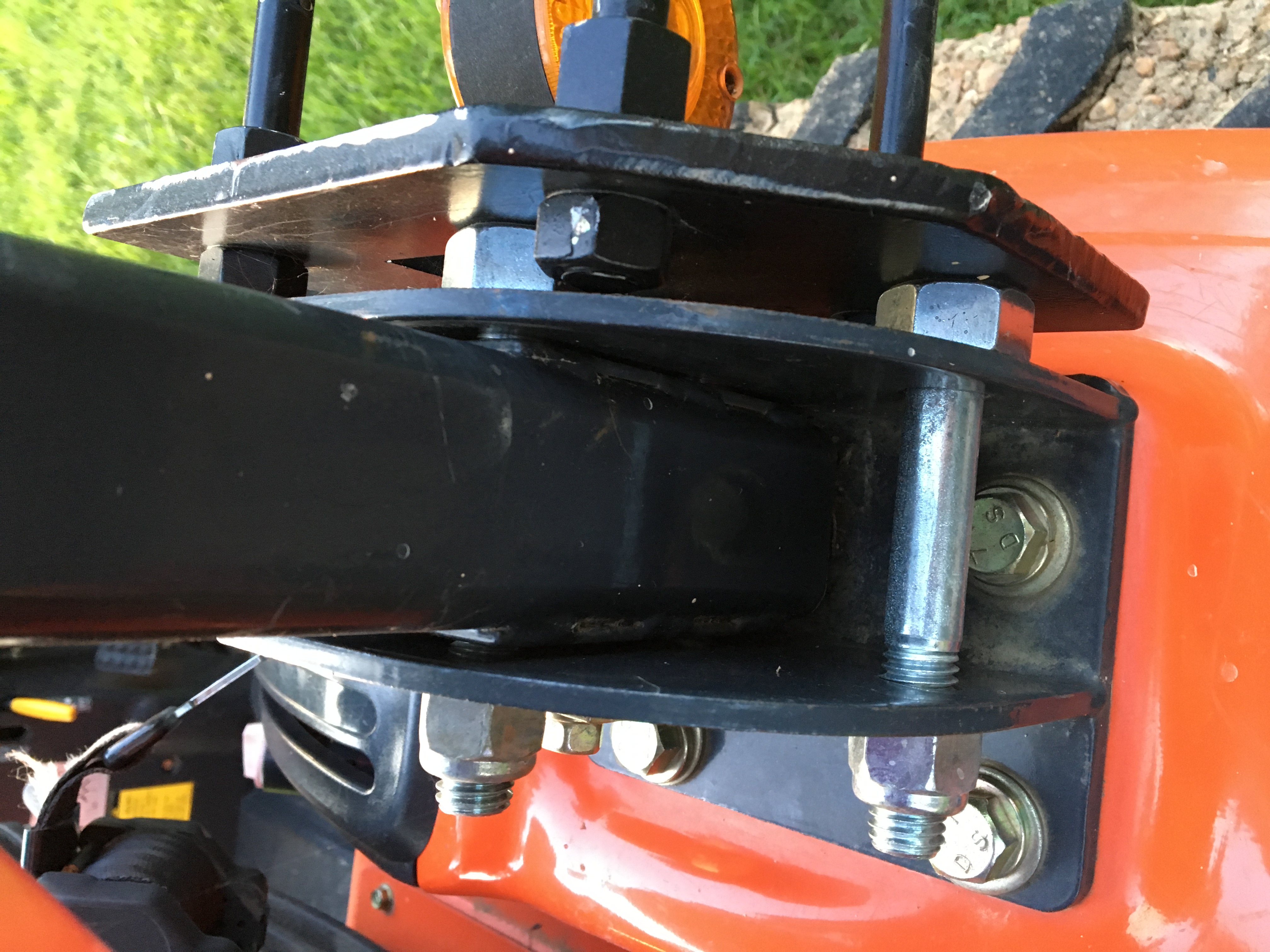

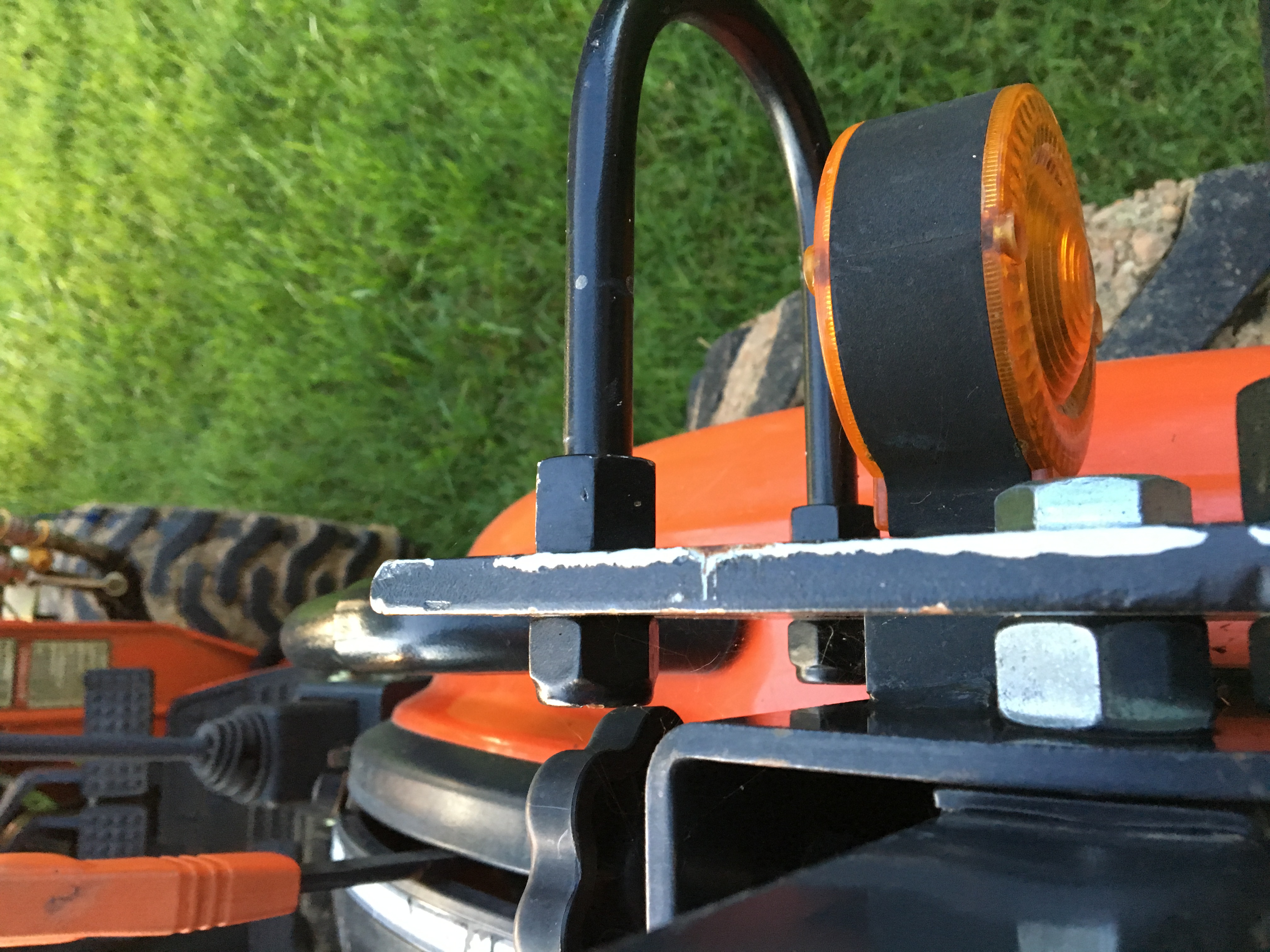

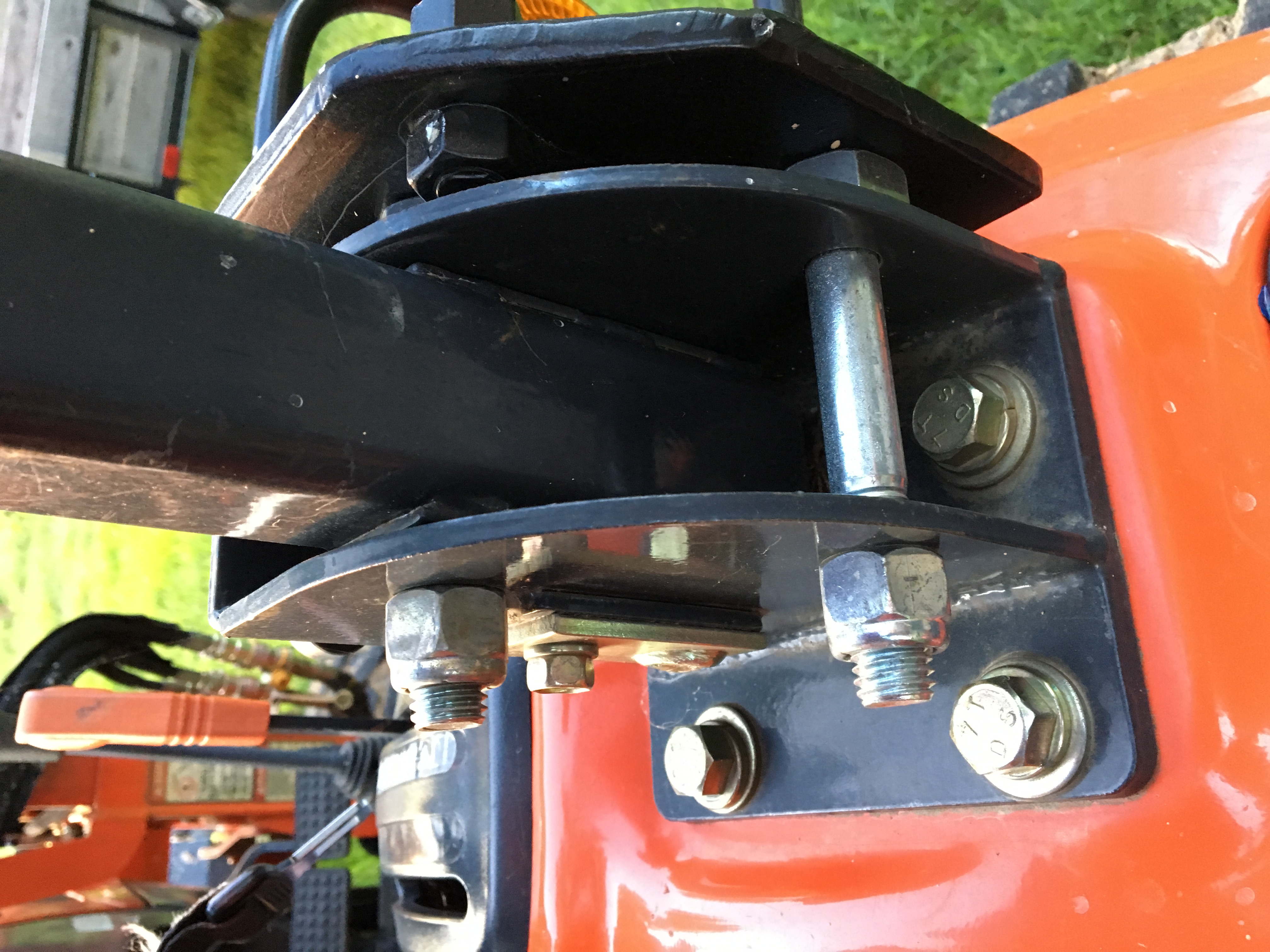

I tried to rotate the pics but could not. Anyway, it is a 1/4" plate cut on a chop saw with holes drilled for the U-bolts. A slot was cut for the light, which had to be taken off and reattached, and the pivot pins for the roll bar replaced with bolts. Took about a day from going to get materials to finish. That doesn't count letting paint dry, getting the wrong size U-bolts, wrong length thru bolts, etc..
It was so easy because the lights are attached to the rollbar base. Your tractor is probably different but you get the idea.
