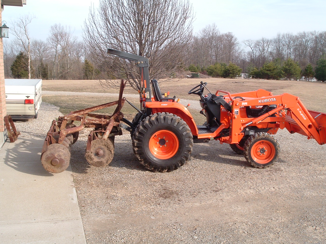

This is the only picture that I have of my disk:

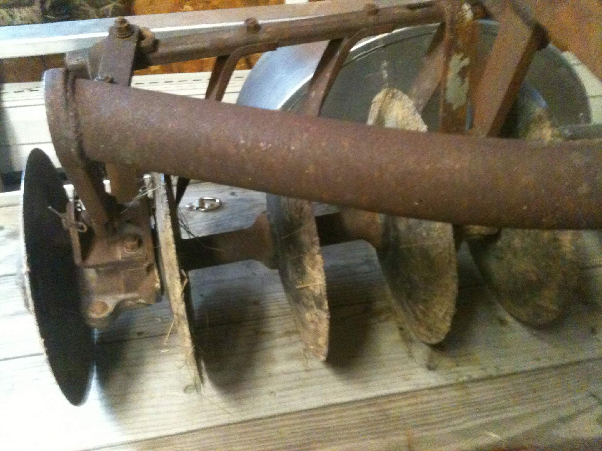

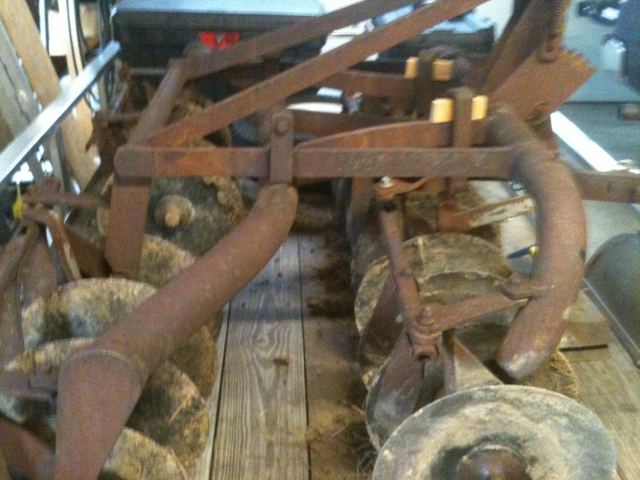

I just rebuilt my ABO 22 disc this past winter.pics from phone 172.jpg Most of the wood bearings were worn bad, so i repaired then with some rock-hard water putty, one was so bad that i bought 1 new one from the woodex co. The cost was about $35.00 but with shipping one item it cost nearly $100.00, yikes i could not afford all, because i put all new disc wheels on at a cost of about $320.00. The out side discs were worn down from 14" to around 12".pics from phone 180.jpgpics from phone 168.jpg I took every nut and bolt off and painted it Fergerson Grey. The bearingspics from phone 198.jpgpics from phone 198.jpg had not been taking grease for a long time, i had to soak and clean all the Zerks to accept grease. Here is a finished picture of my new ABO22.
   / Ferguson ABO-22 disk bearings
Very nice post and a very nice rebuild of your disc. If you don't mind me asking where did you buy the new disc wheels?
   / Ferguson ABO-22 disk bearings #7
I bought the new disc wheels at Tractor Supply, took about a week, my shafts were 7/8" and they fit well.
I plan on keeping a lot of grease in the bearings so hopefully the putty repairs will hold up. Good luck on your rebuild, it was a lot of work but these old discs are one of the best they made!
