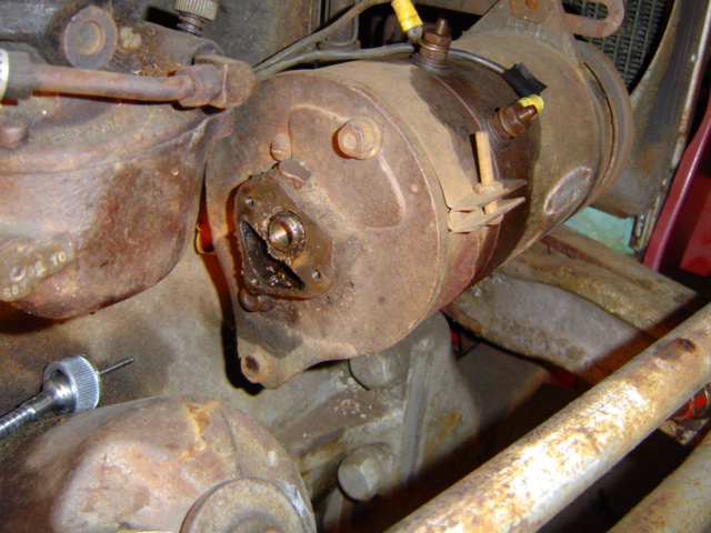

I pulled the little sheet metal plate off the back of the generator "again". After closer inspection and a little scraping, I found the screwdriver slot, to remove the plug in the end of the armature shaft. At first inspection, it looked like a solid shaft, which would have meant a different generator or different armature, in order to install a tach/proof meter. "All is good, that ends well"! :thumbsup:

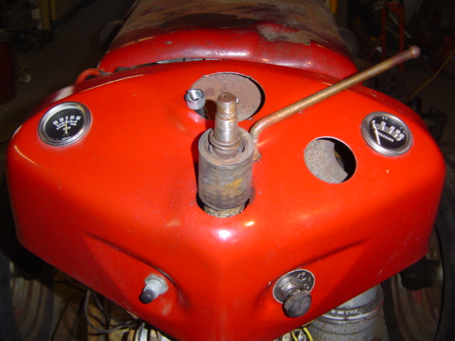

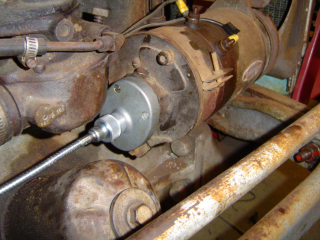

We are waiting on parts ... only the gauges, at this point. We've installed the tach drive and cut the holes for the addition of the tach and new water temp gauge.
I might add, in order to pull the steering wheel, we used a muffler clamp underneath and 3 jaw puller, which worked great!

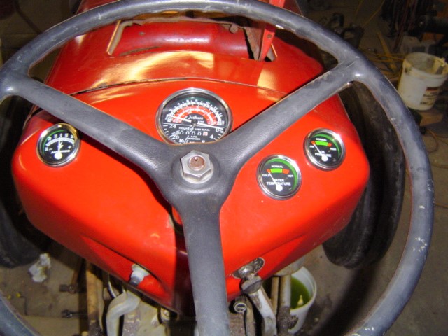

Here is the panel with the instruments installed. To be truthful, it turned out to be a fairly time consuming project. ... the oil pressure fitting was tight against the firewall, so was difficult to get re-threaded, the mounting bolts for the tach were not straight across from each other, so it was a bit of a project to get the instrument straight. There were 2 mounting holes in the firewall, which had to be elongated and enlarged, in order to use the provided clamp and get a socket in there. The ammeter had no lights, due to lack of a good ground to the panel. ... we finally ran a ground wire to the mounting terminal to obtain a good ground, rather than removing the meter and cleaning up the paint covered panel.
Now, I have an electrical question: If the battery is fully charged, should I see a charge on the ammeter, after starting the tractor and turning the lights on? The ammeter seems to go toward "discharge" with the lights on (tractor running). After checking the generator and all of the connections, I'm guessing the regulator might be bad. ?? The generator reads 20 - 40 volts @ the A terminal, with the Field terminal grounded. The ammeter does seem to go toward discharge, when cranking.
   / Ferguson TO 35 Instrument Cluster ????
New voltage regulator cured the charging problem!
