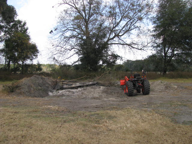

In our development we have a community burn pile.
Eighty per cent of wood burned is hardwoods --- tree trimmings and trees cleared when lots are prepared for new houses; mostly Oaks; some Myrtles.
Ten per cent is softwoods, many species, mostly small trees removed during de-brushing.
Ten per cent is yard debris.
Our sandy-loam high pH due to lime rock content. (Lime rock is mined nearby.)

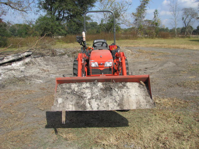

The "dirt" I have been scooping up with FEL is probably 50% sandy-loam, 50% ashes. We have not had a good rain in Fanning Springs, North-Central Florida, for 7-8 weeks. Soil/ash mixture is fine as talc. I assume the ashes are acting as a desiccant.

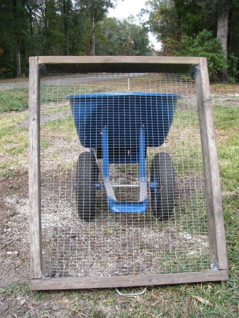

I have been screening this dirt into my wheelbarrow then using it to fill low spots in my lawn. The dirt flows right through the rough screen without me having to rub it much. I toss out the larger chunks of lime rock and unburned wood (5%) and spread the balance (95%).
